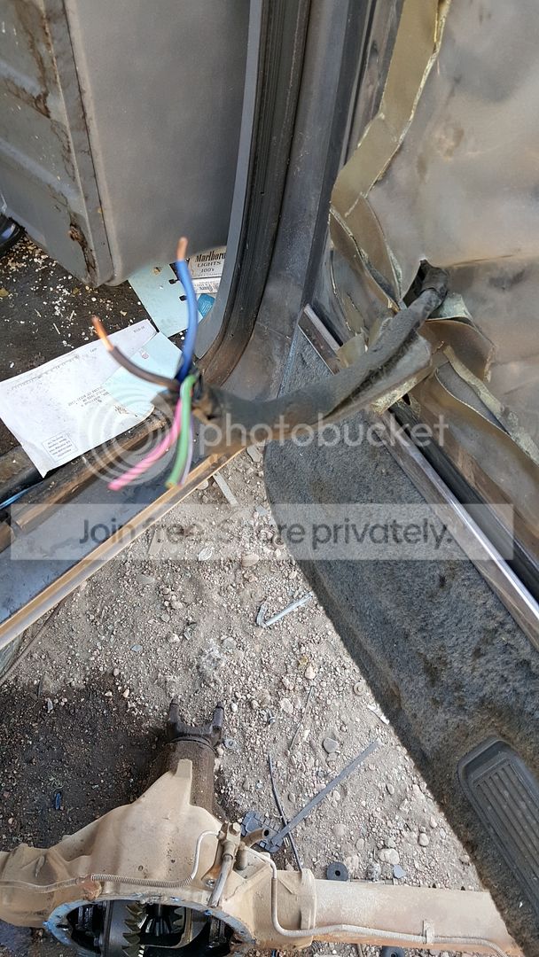

Drill battery worked. Used the blue and black wires.
Up=blue+, black-
Down=black+, blue-
