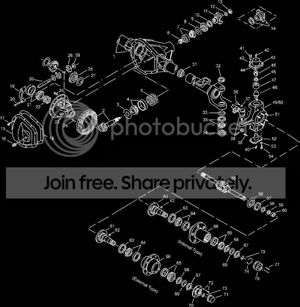

Been awhile since I've logged on. But spring is here and time to start driving my jimmy to the lake. But rotors are warped. Get that bad shaking when I step on brakes. Question is anybody have break pics of removing the hub. I've got about 1/2 the guts out of hub. But there's still something holding the gears in hub. Any help would be great. And plan on getting some pics up this year. Thx everyone.

Thx for all the info. Gonna try and change them out this weekend. And the break down pic is very helpful.
