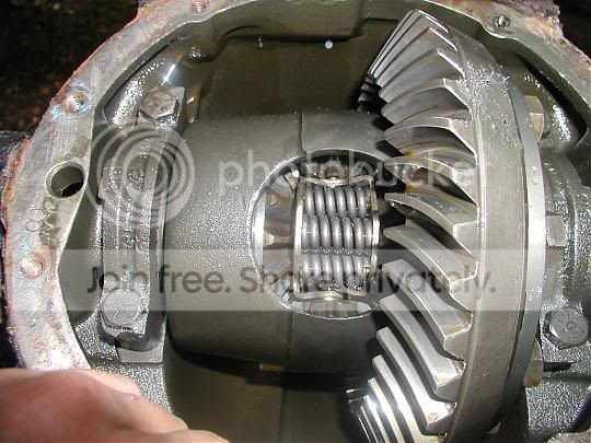

Is this posi removable?
I want to replace it with a lock-right for better traction. I`m also wondering, since the axles are the same spline, if I could put the posi unit up front. I`m not sure if the rear axle being a C Clip axle will prevent it or not. TIA
Yes, it is removable. The cross pin has to come out first, then the spring pack, and then the C-clips will come off the axle shafts.
In order to use a Lock-right, you will have to come up with an open carrier.
To put it up front, re-install the spring pack(fun), then the cross pin, and you're set. The cross pin will act as a locater for the axle shaft on the inner side, just as the spindle acts as a locater on the outer side.

Jimbo - so there are clutches on each sides of the spring pack? and if I put it up front it doesn`t need them?
No, the clutches are between the side gears and the carrier. You need to re-install the spring pack to put it up front--you just won't need the "c-clips"
anymore (up front).
