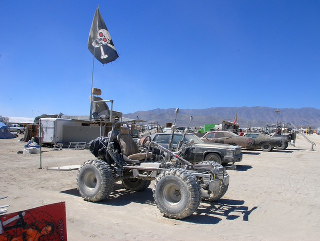

Just take the body off. That thing must weigh a ton. Much bigger tires possible, as well.
