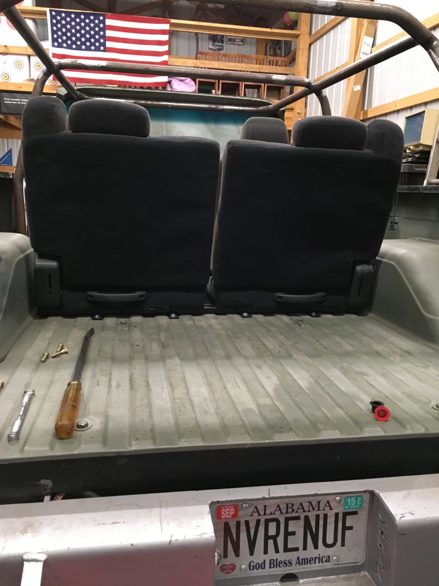

third row seats from Tahoe, Suburban, Escalade, Yukon. 2000 -2006 come with their own seat belts.

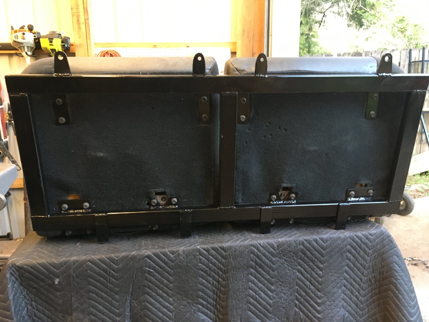

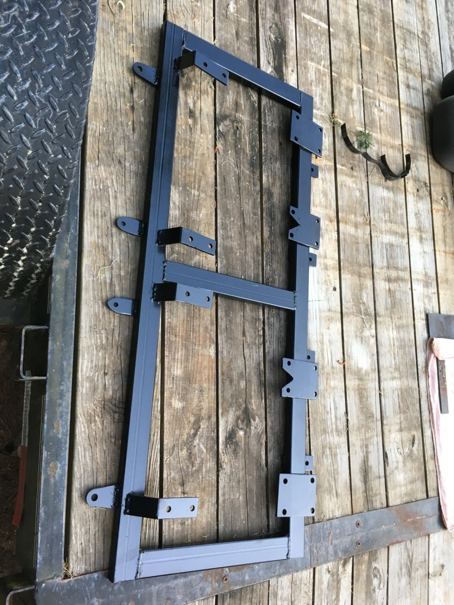

Yep, 00-06 Tahoe 3rd row here. I built a seat frame out of 1x2 tubing to mount it to the rear floor, this kept it real low for more headroom. I found the factory brackets and stuff folks are selling on eBay etc made the seat too tall for adult height passengers.

I like the bracket that you fabbed up, nvrenuf. The thing I hate about the escalade/tahoe benches that I have seen in blazers is that they sit so high. Yours sits right. Still liking the bestops because I want something more weather resistant than cloth or leather but definitely worth thinking about
Thanks @aceroth I was able to get the seat to 1.25” off the floor. It should be just right where water can still run under when washing.
