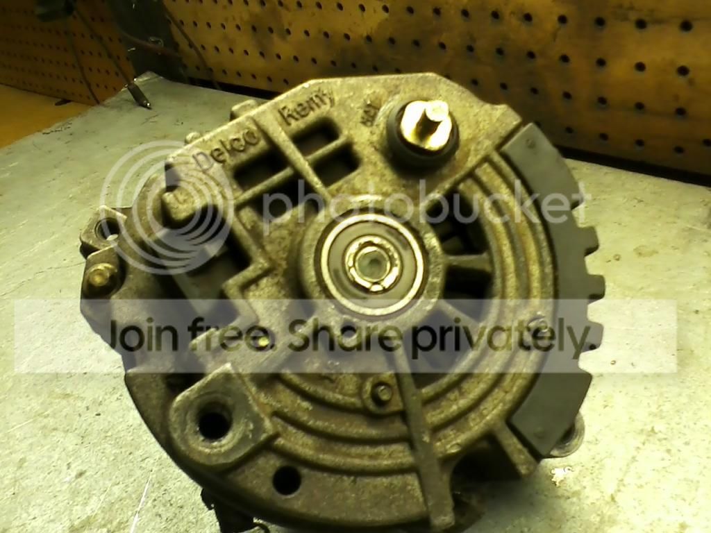

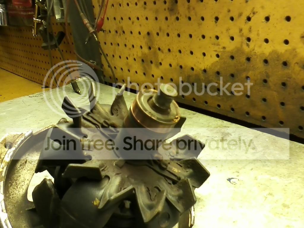

So the bearings in this alt are fine. So are the brushes. For some reason, the end of the shaft is worn right where it rides in the rear bearing. Maybe this IS a rebuilt unit that had a seized rear bearing at some point.
In an evening bout of redneckerry, I made a shim from a piece of steel strap and pressed the assembly back together. Turns smooth as silk now. We'll see how long it runs. Get a new alt? Where's the adventure?

Its hard to tell from the pic, but it almost looks like it was turned down and then the wrong bearing was used.
I would have mic'd it, and if it would clean up, turn it down to the next bearing shaft size and used a different bearing.
Otherwise, I would have turned it down smooth and put a slight chamfer on the end.
Then made a sleeve slightly larger than the original diameter that was a light press fit.
Pressed it on, filled the end gap formed by the chamfer with weld, then cut it down to standard size and cleaned up the end weld with a cutoff tool in the lathe.
The reason for the sleeve instead of the MIG buildup, is to prevent heat from damaging stuff on the shaft.
I bet if you had cleaned the shaft and bearing hole up good with brake cleaner (without washing the lube out of course),some J-B Weld or Quicksteel would have bonded the shaft to the bearing race well enough to last the life of the bearing..
I considered all of those ideas. If I had a lathe, I probably would have welded it up real lightly and turned it back down. I really don't know where to find a suitable sleeve. Hopefully the staking and loctite will keep my little shim in there until something else fails. I did drive it about a mile yesterday and everything was fine.
