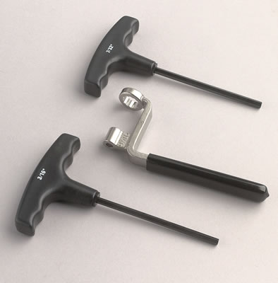

The rocker arm nuts you have are called poly locks , they have a set screw in the middle of them ,that you have to loosen or back out in order to set the valve lash , then you just set the lash as you would with regular rockers ,tighten the outer nut to the required setting ,then while holding the outer nut from turning you take an allen wrench of the correct size & tighten the set screw in the middle repeat 15 more times & you are done .
here's a pic of a tool for it JUST to give you an idea of how it works.
as stated above, the set screw locks in the adjustment...

you see that allen set screw in the middle of the big hex nut?
you back that set screw off then adjust nut and then lock down the set screw to jam the nut tight in place.
Boy I wish I could delete those posts! lol. I figured it out:-) Just for reference the allen nut is inside of the nut that tightens down the rocker arm. Now if only i knew how much to torque the nut. Well i feel retarded:-)
