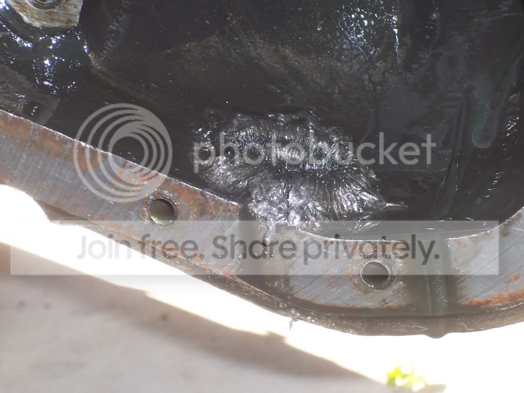

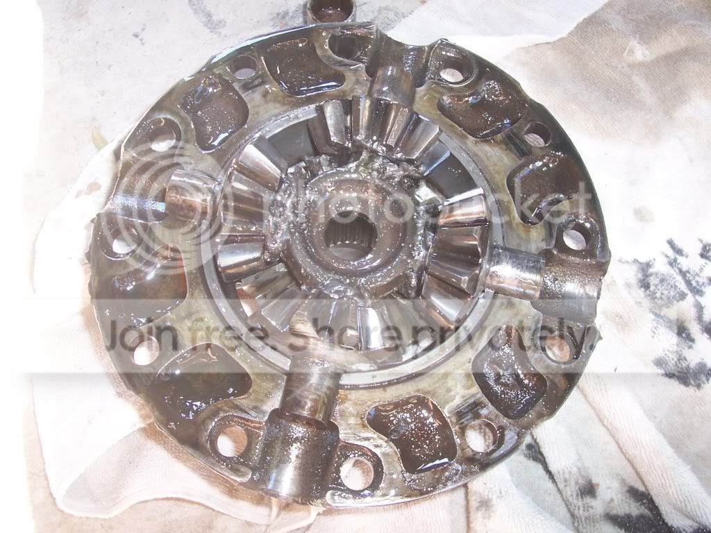

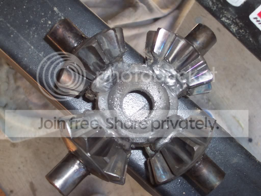

So I finally got time to tear into my 14 bolt to look at what all was trashed at Blazer Bash. The welds on the spiders broke loose and the metal shards floated around in there for at least 20 miles getting off the trail and back into town. Surprisingly nothing looked messed up, so I just fished all the chunks out, cleaned up the magnet, rewelded the spiders and called it good. I added a little more and cleaned everything up after the 3rd pic but didn't take anymore pictures
no wonder they broke, you didn't weld enough. you need to weld the 2 side gears to 4 little gears and make it one big ball.
