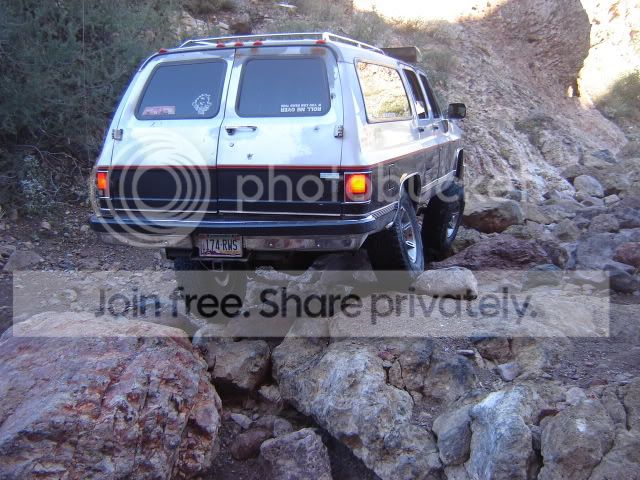

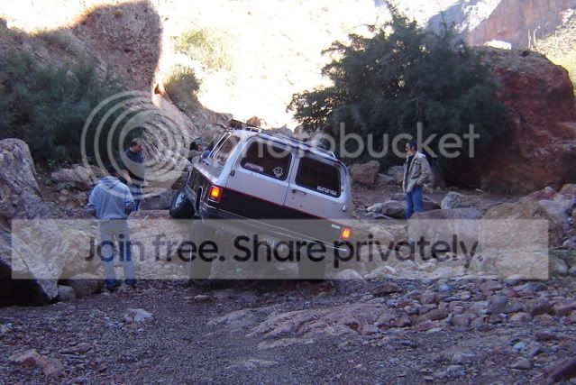

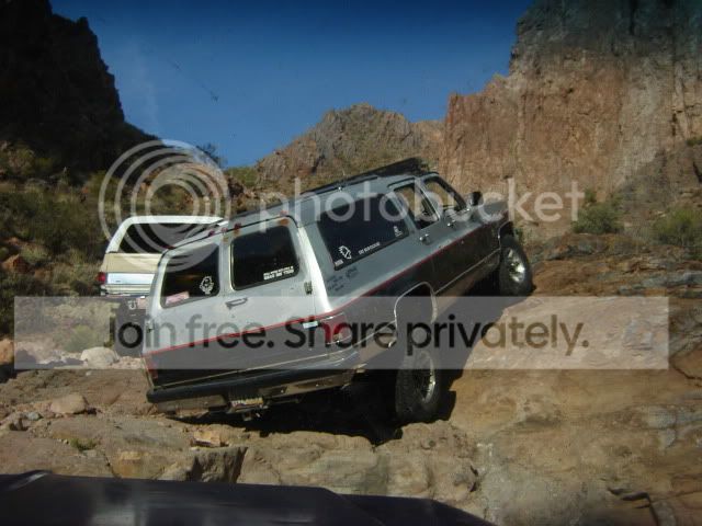

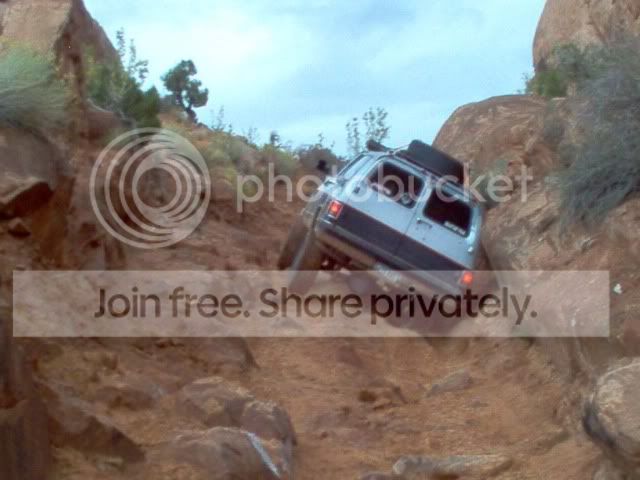

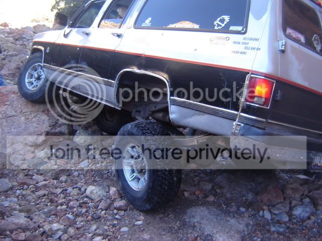

Really, 16.5 forever on 3/4t and now 17 is a bling rim?????
Huh?
Martin
16.5's don't have a lip on the inside of the wheel like basically every other light duty wheel does. That means they are VERY prone to the bead popping off, a poor choice for a four wheeling tire unless you use something like the H1 double beadlocks.
I am aware of the lack of a bead lip. I still like 16.5" wheels. I have only had one come off the bead, and that is because the tire was leaking air all day after I lowered the pressure, so it had no pressure in it at all at the end of the day. The other three tires never gave me any problems at 8 psi. In do run inner tubes, so I think that may help.
