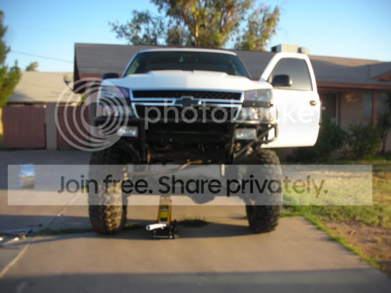

I think I will mount one up on the rim I have and see if I like it, my concern is the tire hitting the radius arm.
Those are some nice , huge tires ............... does that mean your going to finally regear and mount a front driveshaft :thumb:
whats killing me is that I actually like the tucked in look, but the truck does need to have a wider track width for some added stability.

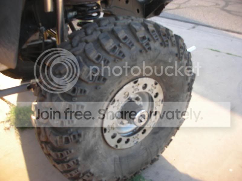

today I did some measuring..
I grabbed a wheel/tire off the buggy to have a look. At full lock it rubs my shock mount that is located on my radius arms. This is on a hummer wheel with 7 inches of back spacing and a 1 inch spacer. The hummer rim is 16.5 x8.25 for the bead mounting surface.
the rims I have a 17x8" for the bead mount surface, these have a back spacing of around 5.5 inches. So I gain 1.5 inches with the decrease back spacing, if I was to swap to a 2 inch spacer this would put me around 3.5 inches of back spacing and should not contact my shock mounts and I hope would give the truck the right look.. Issue I have is that these rims bring on the bling:doah: and they would get damaged I am sure.. "dents and scratches don't scare me to much though" The idea is to mount one on the bling rims and see if I like it..problem is the bling rims are 17" rims..and the other favorable rim options are 16" rims.. so I would them have the wrong tires:crazy:
the 17's cost me 300.00 to buy them back and where ever even used since I sold them.
a set of just steel wheels is 400.00 and from there for anything special the price jumps to 200-250.00 a rim..:doah:
I do like the tuff/rugged and tucked in look of my hummer wheels though..

Currently I have mismatched gears and bald rear tires...so I wont bolt it in untill its all done. I am dealing with the lift and tires at the momment. Currnt issue is that the new front springs I put on are still as hell so I am going to see if the weight of a new bumper, winch and dual batteries are enough to combat it.. for the rear I ordered some deavers:woot:
gears are 5.38 and a powertrax or lock right up front, along with all that the 205 needs a rebuild really bad:(
Its not done but I am getting close, today I ordered the 17x9 series 97 rock crawler wheeles and the 41 inch irocks fo it though.
between 745.00 for rear springs and 2000.00 for the wheels and tires this truck is a money pit again. Cant wait to drive it though on balanced tires:haha:
