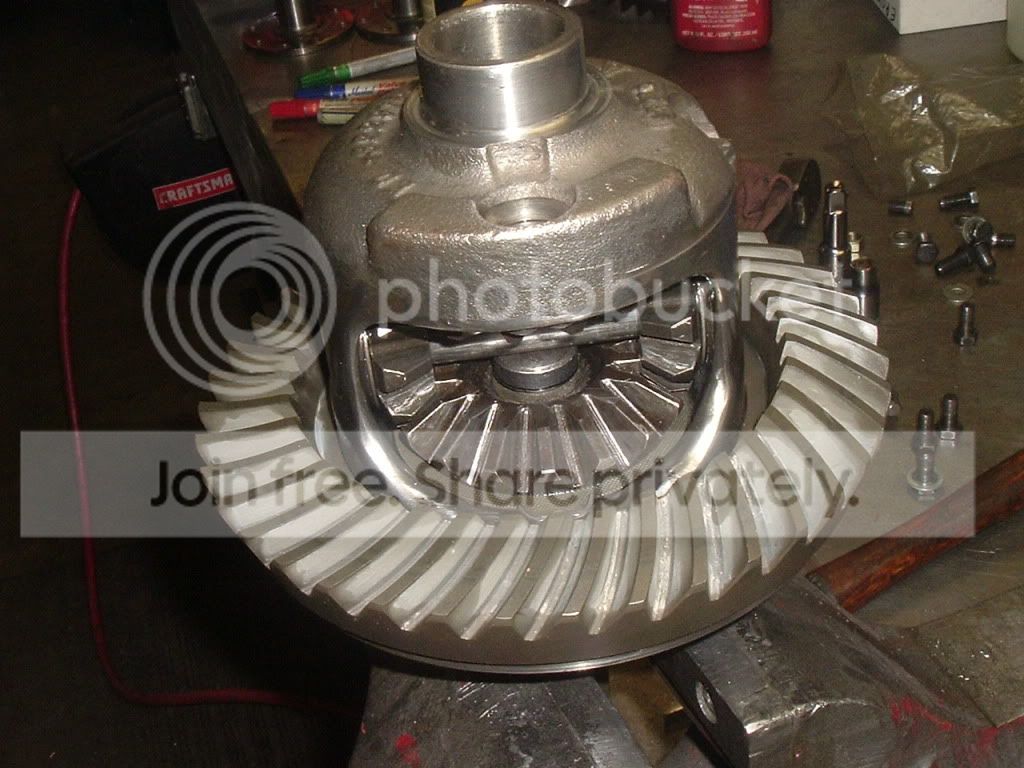

I didn't set these up personally, I had the 10/12bolt diff polished and blueprinted by a pro corvette diff guy...Richmond 3.90's with 12 bolt spiders and cross shaft, and 31 spline Tom's Kickass axles.

that gets alot of people Vinnie, they are set with just a few thousandths clearance to engage the clutches all the time, but just enough clearance and lubrication (Lucas and GM posi additive) to allow turning without chattering.
built by Gary Ramedai in Conn.
