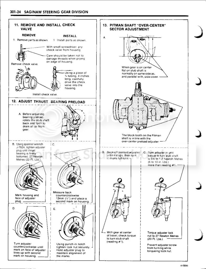

to adjust the steering box you will need to take it off the truck (check your frame while you are in there)
to check your steering linkages have someone turn the wheel back and forth with the engine running so the power steering is giving its effect.
to check the tie rods/ball joints jack each side up and see if you are able to move the tire in any direction. keeping the other tire in the ground lets you feel the slop in that area.
the worn gear on the steering box is a common area of play. you need to have it off the truck and the steering pump lines off. turn the steering back and forth to pump all the fluid out. then follow the procedure here
