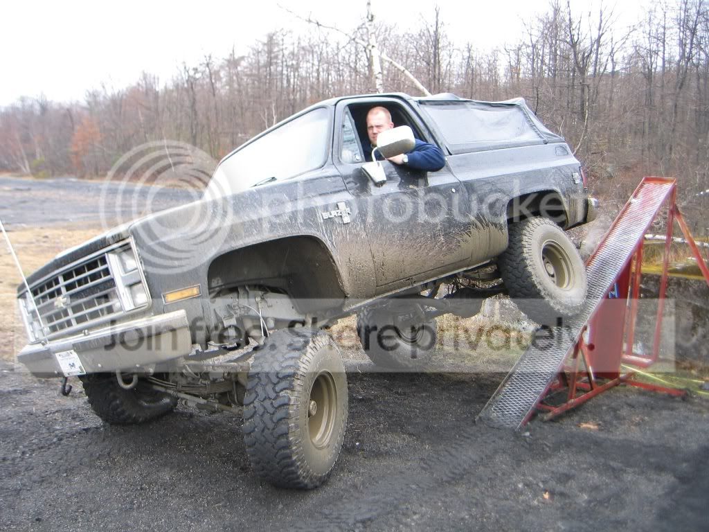

mrk5's setup (52's in the front, 56's in the back with the shackle setup he described a few posts up).
The lower you can keep it, the better IMO. My suspension is at stock height and I would have it even lower if I could (interference between the crossover steering arm and the springs).
That's just sick. That's one stout RTI ramp!
It's actually pretty light weight considering. Chris (38377k5) spec'd it out for me on Solid Works using 2"x3/16" angle as the material. It's the standard 20° ramp that would allow a suburban or longbed to reach a perfect 1000 score and even just a little over 1000.
