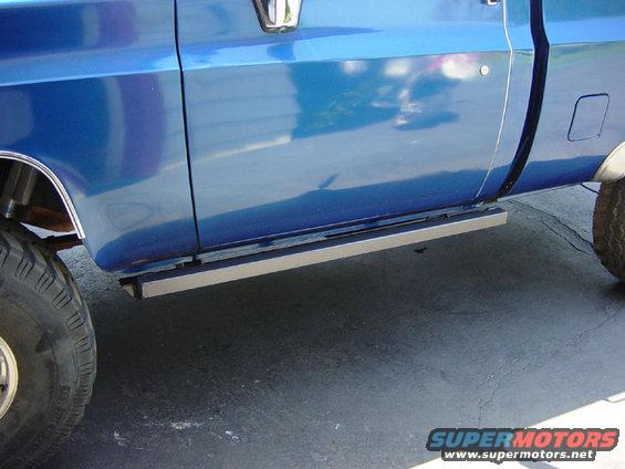

I built them for my '79 pickup truck. I mounted them to the body, the front mount to the angled body support and I ran a 1/2" plate at the rear where the seatbelts mount to the floor. It was a tricky design, but I have landed hard on each of them multiple times and they haven't moved an inch; they have saved me many times! Here are a few shots, let me know if you want more.
