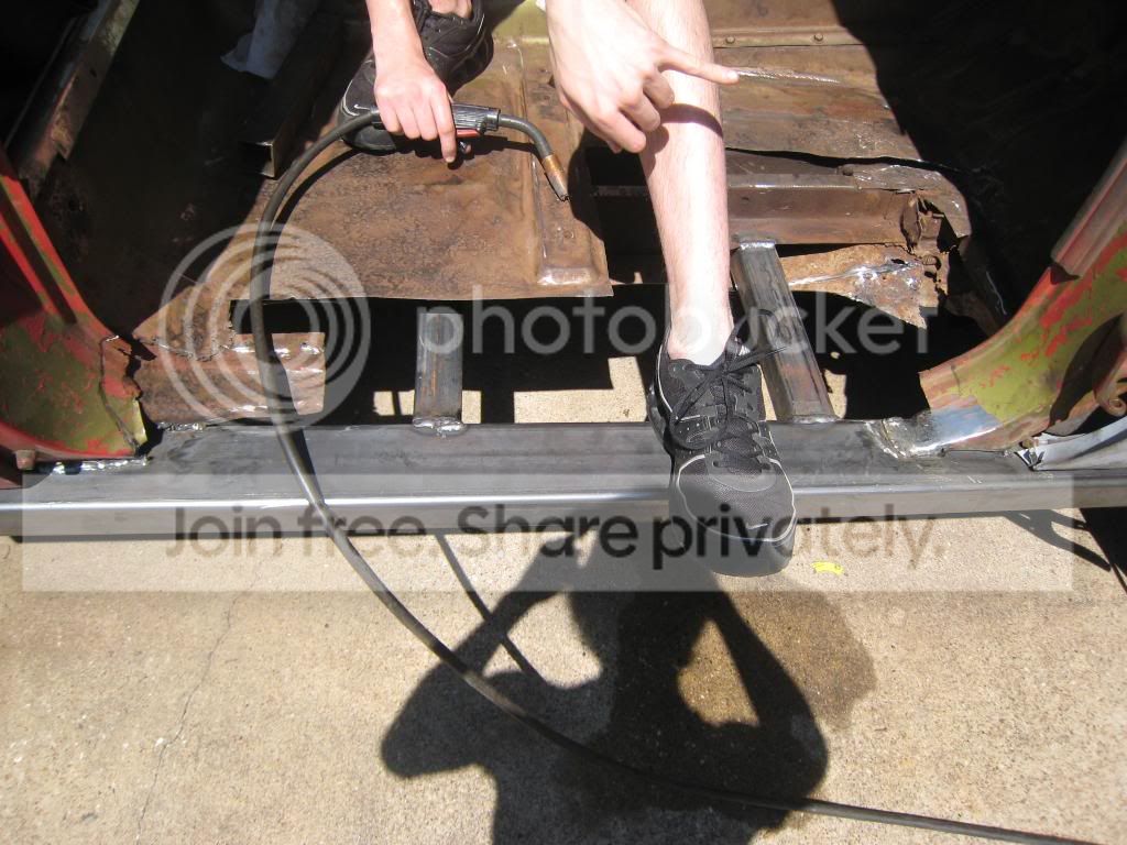

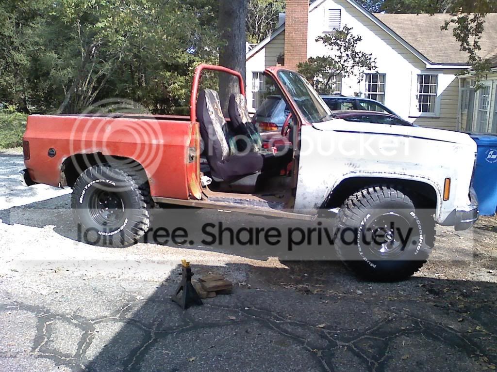

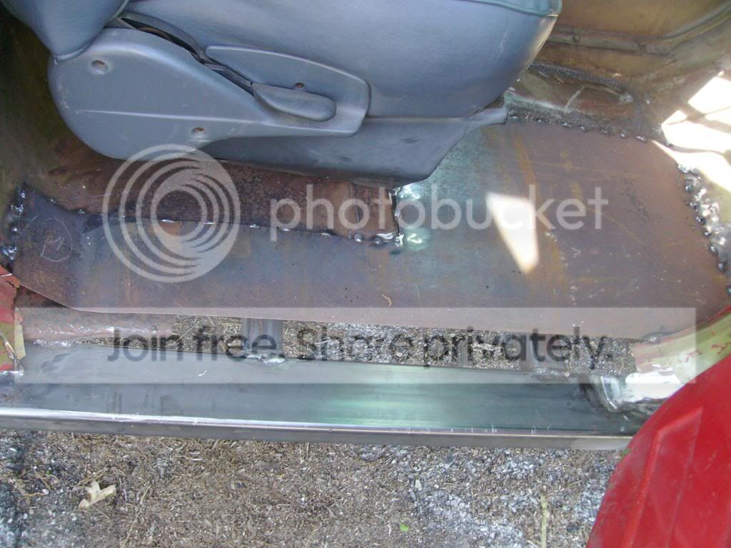

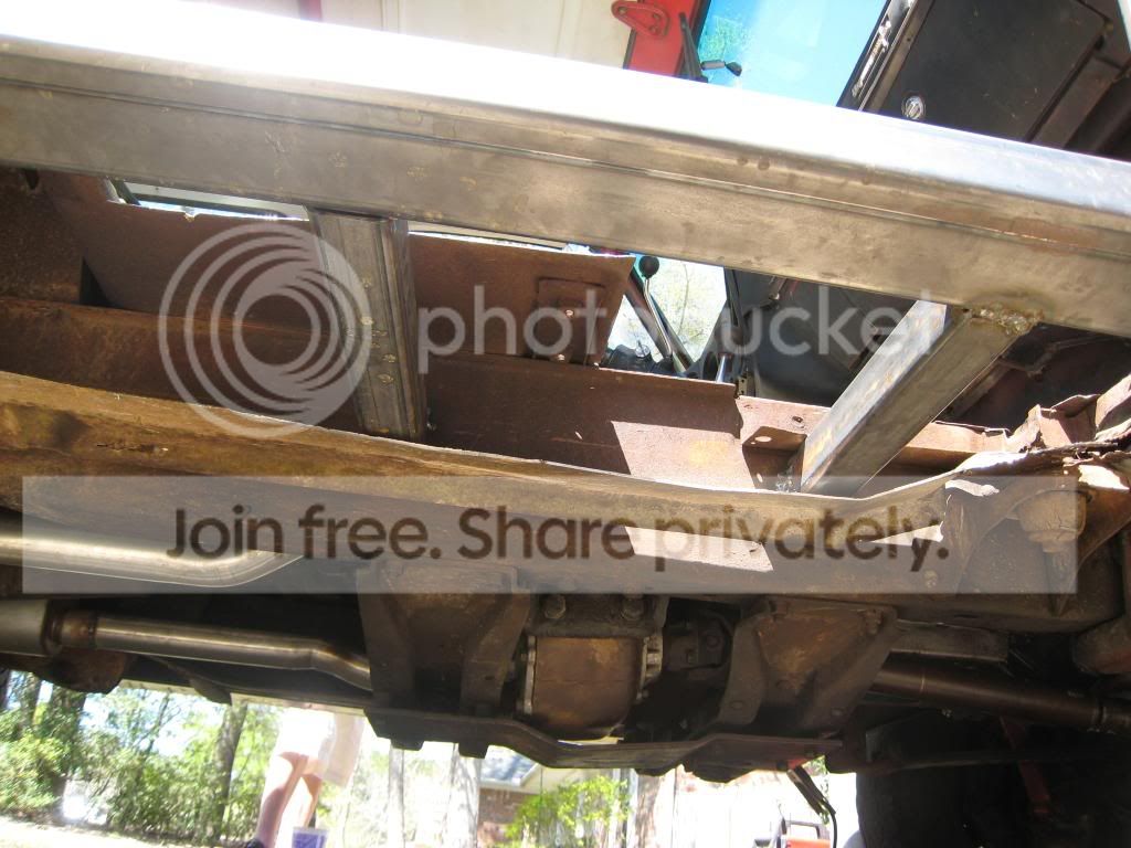

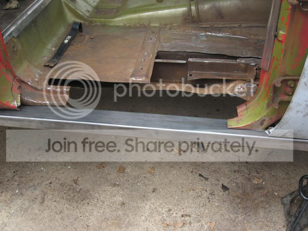

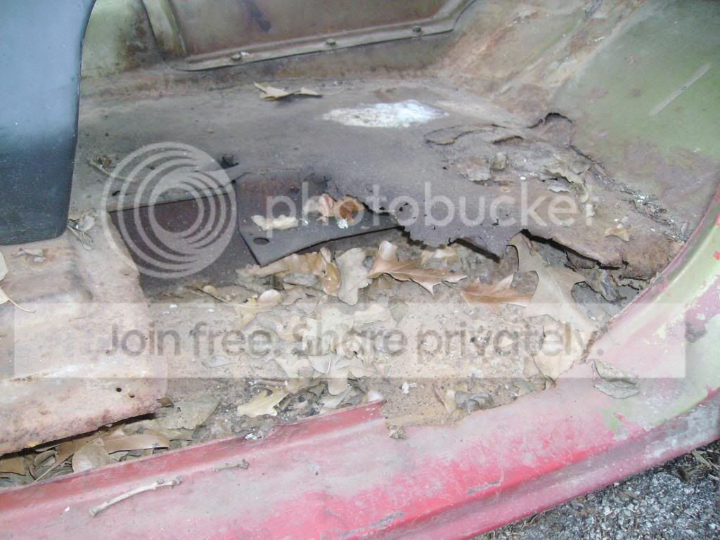

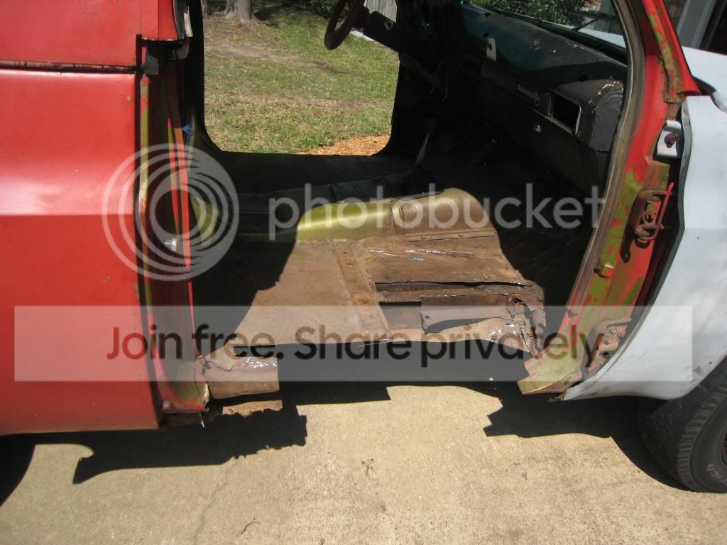

I didn't convert to a full 'vert('73 K5), but I cut out my rusted rocker boxes. Put 1/8" wall tube in. Here's some pics(sorry. I'm kind of a pic whore haha):

if you're not going to cage it, and you're not going to install a tube-rocker, then you're out of options. you don't have to install the rocker tube up as high as stevo did - it could look fairly stock. But, you have to do something to prevent flex in the floor boards and a cage and/or rocker tubes are the only ways to do that. I prefer both.
