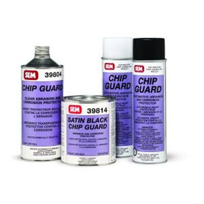

another option would be clear chip guard on the lower part of the body.... we used to do it all the time at the collision shop...
I've heard about that stuff.. do I just go to any collision repair place to have it installed? I wonder if Ziebart installs it..

I've only seen that stuff last a short time before it starts flaking off....
I think you really get what you pay for, and for rocker panels, you really need to get them prepped well to provide adhesion for something tougher like what Paul posted up, or some commercial bedliner material.

I think I'm going to go without mudflaps and save some money. That SEM clear chip guard sounds like the way to go (thanks ryoken). I've also been told that you can get clear plastic stuff too (same as clear bra products for the front of a car) although I don't know much about it
