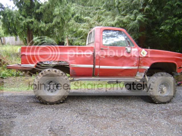

Here's mine. I have a 2" body lift so I tucked the tank up 2" They work well and I've beat em and jacked on them. It works good.
This pic the truck was in the middle of some mods but you can see how the slider sits.
i like those.
4Wheel Offroad Magazine did some on Operation Army Truck a few years ago. They did it similar to the red truck above, but the truck they built didn't have a body lift.
Sure you could do it with out the body lift. The skid plate would just have to be a little different.
