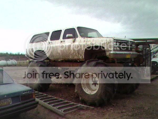

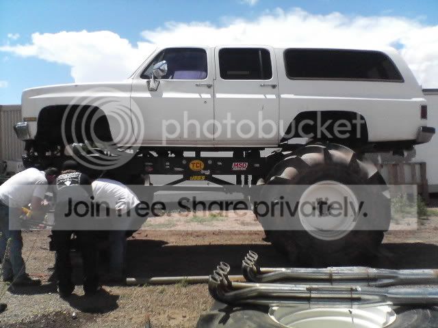

I could be wrong, but I don't think even stock rockwells will hold up well to 53's. quote] For massive hard core crawlin' probaly not but for mud they will I have a buddy that runs 66" rice and cane tires on his rockwells and has been for nearly 20 years with no axle breakage and at one point this truck had twin 454's it now has a burb body on it and Tbi 350 i'll try to find some pics
heres the Pics obviously this thing is for deep mud only BUT the crazy **** has actually jumped it a few times and lived to tell about it the first pic is old this is when it had twin 454's the second is how it looks now
Damn and I didn't think there was any mud in New Mexico just goes to show how much I know

Here's some more of the truck my buddy has those are 66" rice and canes

Nah you just climb the lugs of the rear tire and open the door and climb in it's not to hard . the bottom of the door is just a shade over 6 foot on the gooseneck trailer it's 2" shy of legal height limit for New Mexico .It actually drives decent 35-40 mph is very manageable the way it's built is kinda hack .....okay way hack by CK5 standards but it does what it was built for and does it well (plus the A/C works awesome)
