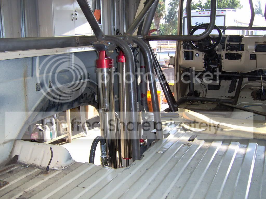

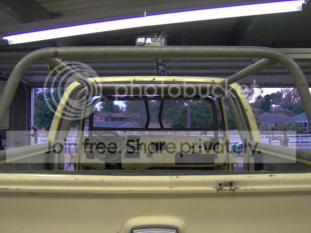

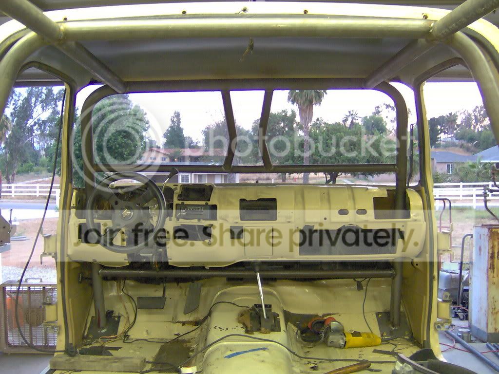

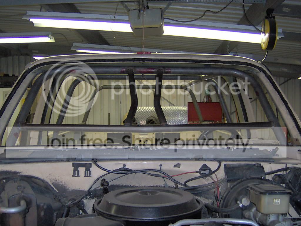

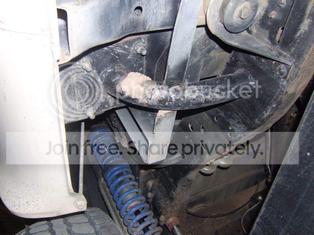

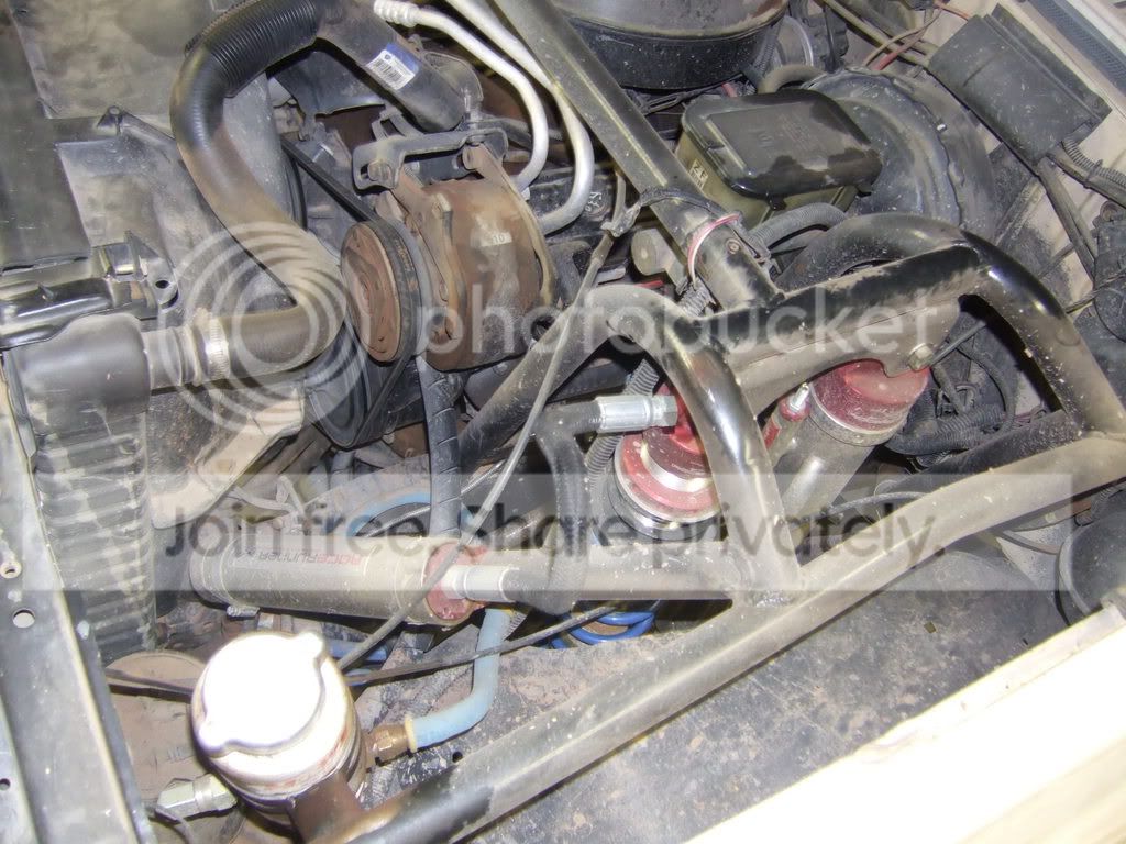

I ran my a pillar bar through the dash. Tied it ti the frame through the fire wall and to the core support. Ran new seat rails to b pillar bar. Tied the bars to the frame under the hoops. Here are a few pictures.
what a setup! its a lot more than what i plan. i like the ideal off the 1 peace A pillar. nice pictures! my plan was too have a bar welded inbetween the two side bars just above sun visors was hoping too keep them?
