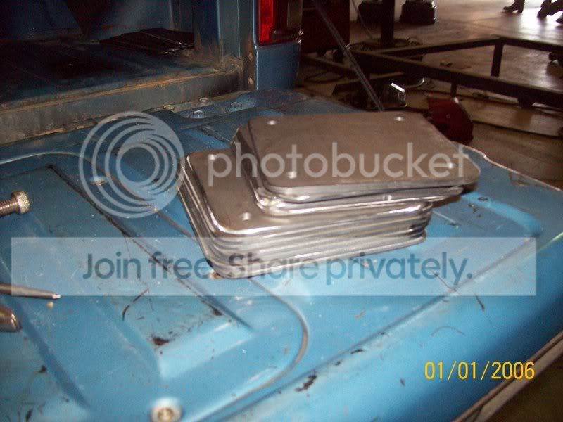

Oh, I ended up making mine from 3/16" plate and running 7/16" grade 8 bolts. (I was planning on 3/8" bolts but, my drilling was crooked.:doah:) Pic (ignore the date, the camera is broken!):
