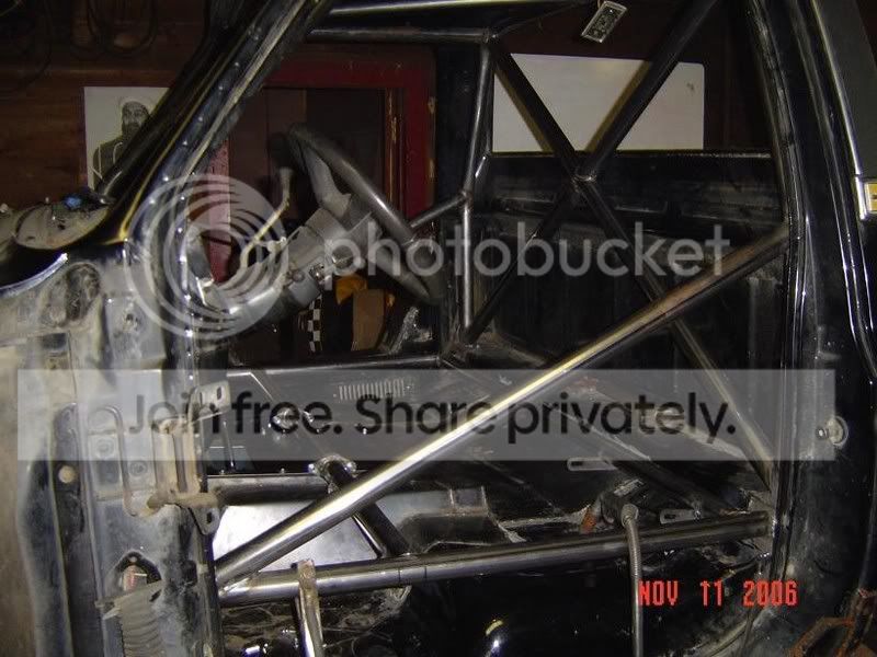

    I've got one pic and only one pic. The A pillar's go through the dash to floor plates. The angle door bars connect with the A pillars at the floor plate. Still have a few things to finish. It's tucked as close to the body as humanly possible[reads : pain in the a$$:haha:]

    What was your trick to welding between the bars and the body? At risk of sounding sick, yours looks much tighter than mine.:o

    Not sure if there is much of a trick other than having someone that is very talented with a welder.
