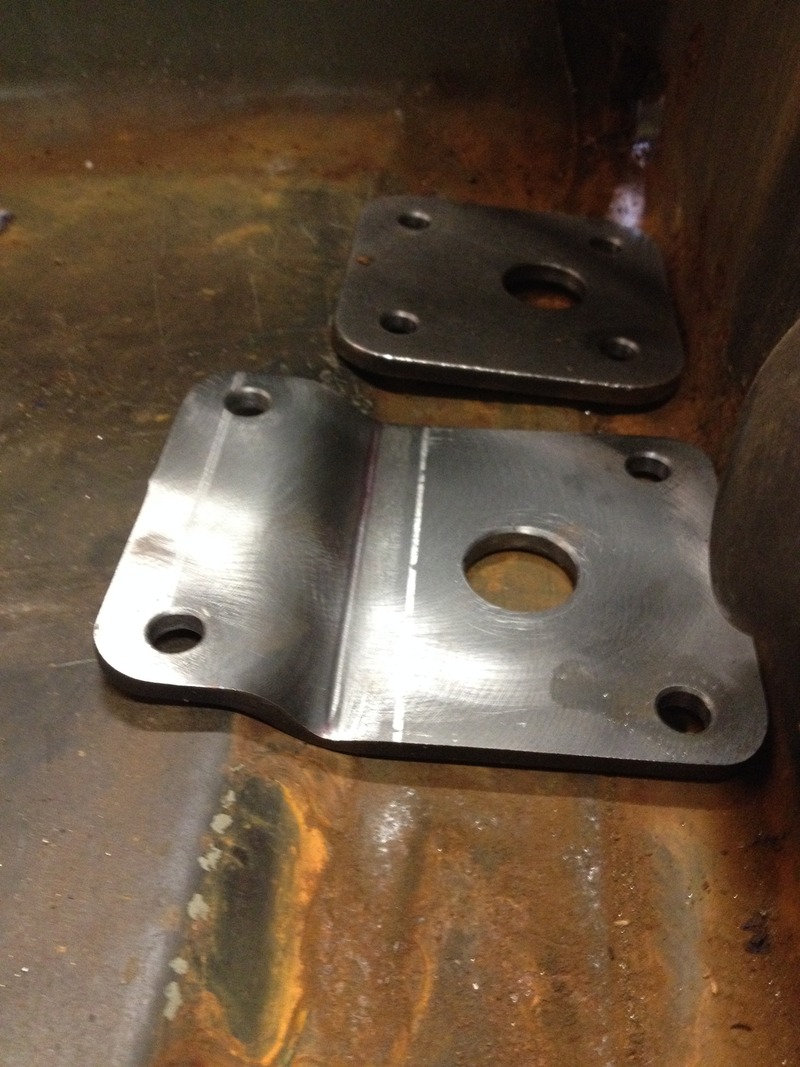

Watch the floor shape under the B pillar, the floor plates I got overlapped a 1” tall step. I didn’t like the gap between the plates and floor, I was worried it might continually loosen until it finally compressed the floor flat. I had Kert make me some plates with a step that fit great, I got the feeling he thought I was overthinking it but it made me feel better.

I also had him make me bigger C pillar plates so the bolt holes all landed on a high rib instead of the gap.
This is helpful. I've wondered about both of these spots but haven't mocked up the plates. You think if I asked he'd make me some like that?
Probably, I think he saved all this info on orders. I believe he is a 1 man show now though so wait time may be longer.
