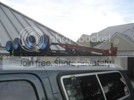

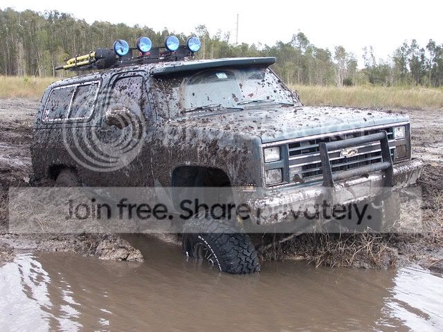

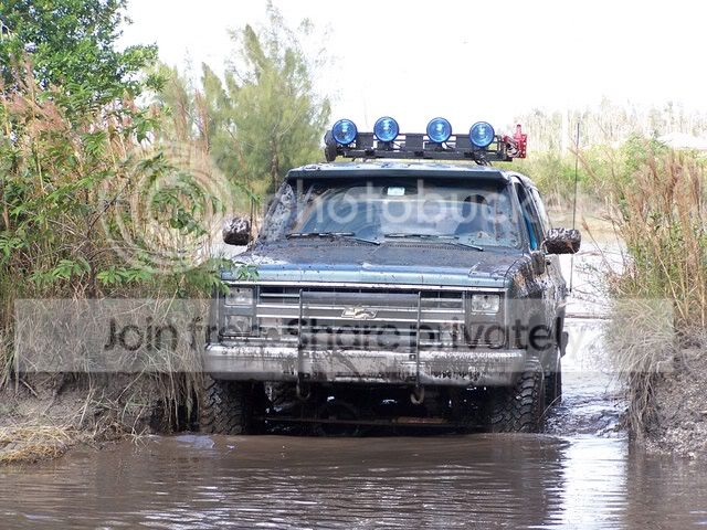

Ordered from Summit. We've loaded a gas bbq with 3 tents and chairs on that thing without any issues. Only regreat was not buying the longer rack.
Is that a Surco?

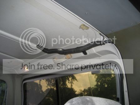

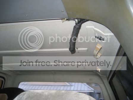

How did you run your light wireing and what do you do when you pull the top off?
Im thinkin about putting one on my K5 as well. Would be alot nicer for hauling the canoe in the summer. Is that a westin bull bar too?

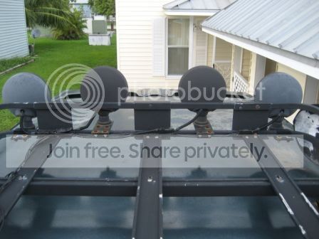

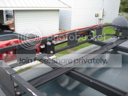

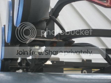

Can we get more pics of that rack, esp how you mounted it from the INSIDE>
Thanks a bunch. :D

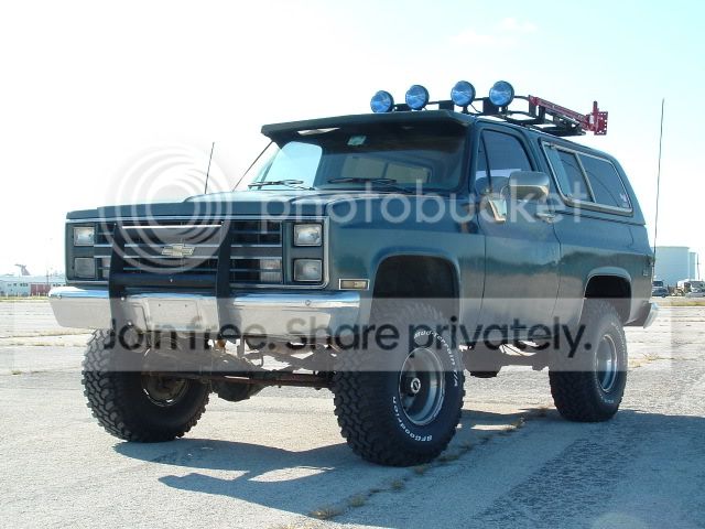

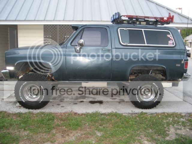

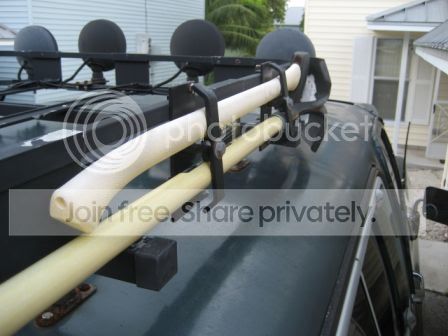

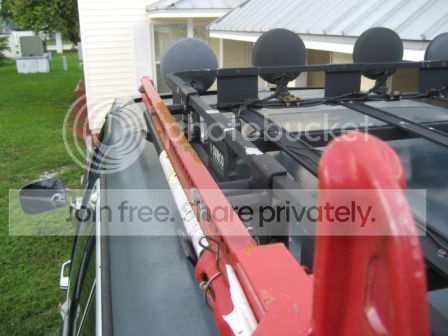

Yeah, it's a Surco rack. I sold the truck to my brother so i'll have to ask him to send me some pics. He added the 6 light tabs (4 front/2 rear) and the hi-lift and shovel/axe brakets from Surco. The lights were run though one drilled hole near the front driver side mount. It was then sealed with a silicone caulking (cuz it's easy to remove).
Here are the best pics i have right now.

Here are pics that he shot. The Key West salt air is a problem, but he plans to repaint the metal parts. The black paint has flaked in some areas on the aluminum, but this is after roughly 4-5 year of use. Also the wiring was rushed.
