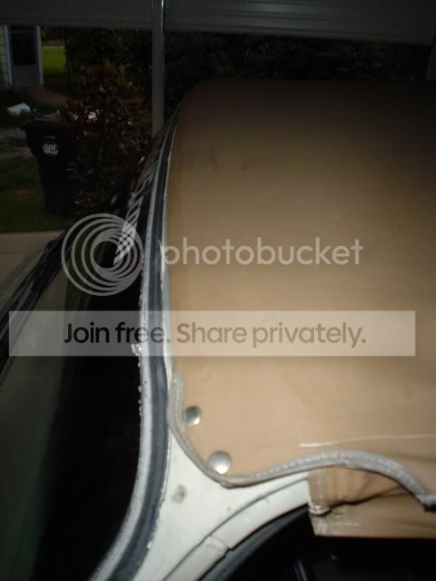

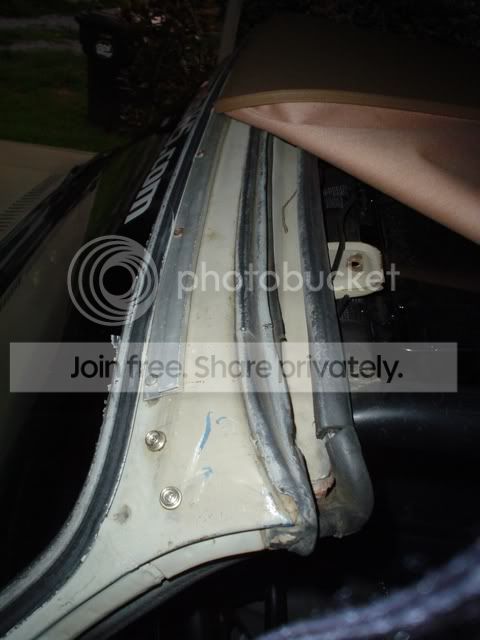

Went out and snaped these fer ya.................'bout dark!
Don't see a problem with yer idea, if you don't use a hard top.........I don't, even though I have two.
There is a brace that is inserted into a drilled into the windshield frame, should be easy for ya to weld a metal plate/brace for it. Get ya a photo of it later.
That's what I'm talkin 'bout :D Looks doable. I'd just have to get the door pieces for when I cut it and the rest I think I'd be able to fab. Might be no more expensive going this route vs. replacing all the seals on the cab/topper, rear window seals, Replacing my crappy sliders with solids and My rear window is scratched from years of having worn widow belts. Not to mention, much cooler :wink1:

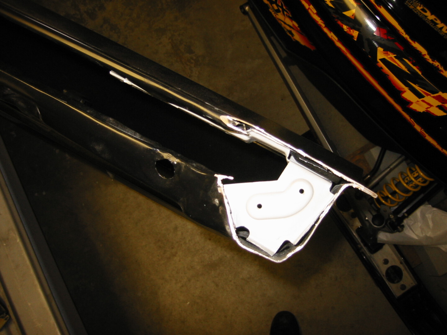

Don't forget to renforce the the body somehow, as the '73-'75 have a heavy sheetmetal box welded underneath the body on each side. Unless it's for street only. Post ya a pic of my rusty '73 ones WIGAC.

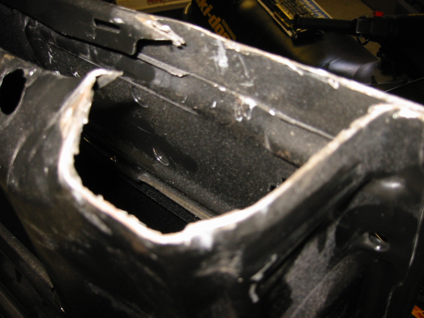

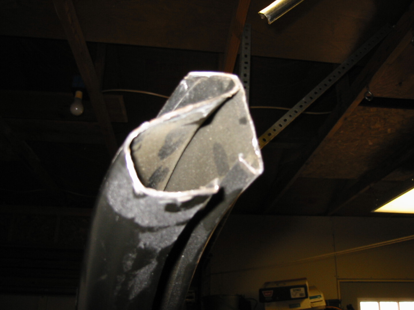

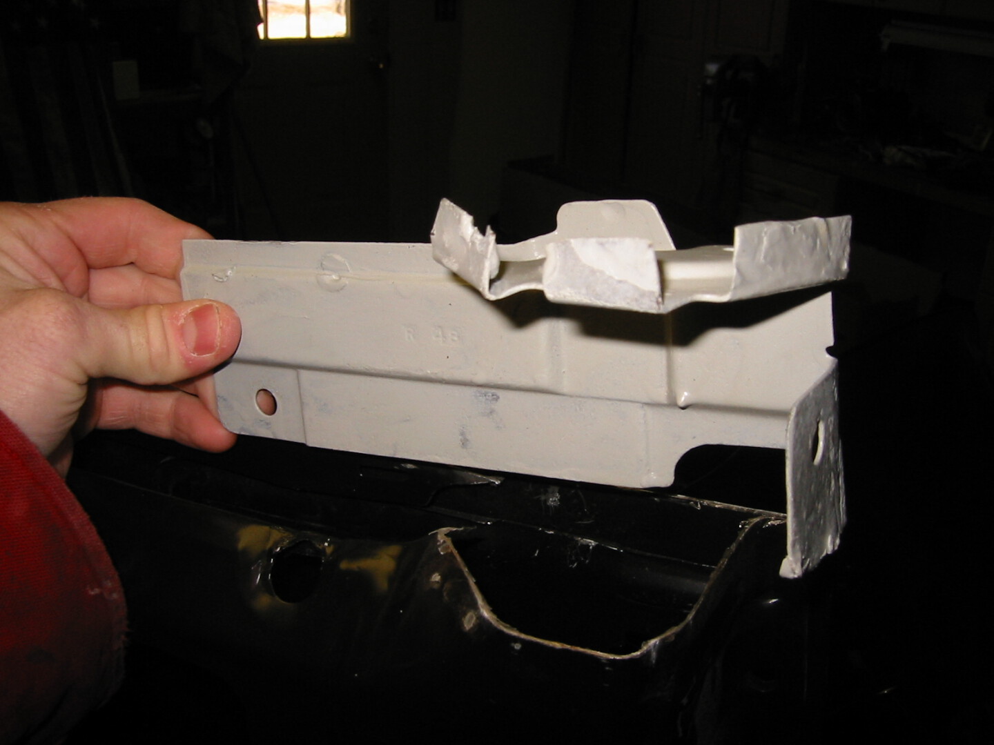

It is the 73-75 K5 door reinf. When you cut the door post, that section becomes very flimsy. It's an important section too because the door handle you pull on is right there. So the factory had added this reinforcment to K5 doors ('73-'75) to strenghten that area. That piece ties inner and outer and back surfaces of the door, also holds one of the handle bolts and has the screw holes for the post cap. The top pic is that reinforcment installed in the door.
Ohh nice. Thanks. I will be doing the conversion myself maybe before the summer. I've got the doors from the '75 so I should be ok. I am missing the piece that fits directly on top of that support. Any idea if it is available from LMC or somewhere else?
Those are not available from GM anymore. They are available from Chevyduty, or LMC. Although I don't like LMC's, they are really thin plastic, and no weatherstrip on the bottom side like the factory had to seal around the window when its up. I would imagine chevy duty is the same, but who knows. I saw a pair on eBay (NOS) a few months ago. Probably die waiting for them to show up again though.
