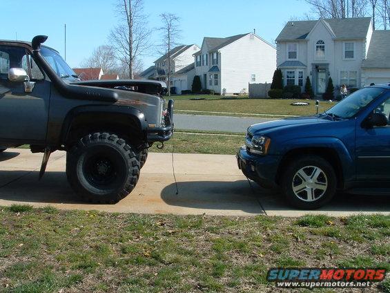

my truck may not be big but someone in a trailblazer may not want to play chicken... :rotfl

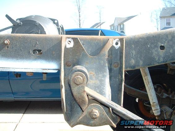

took 4 rivets out so far.. 2 top on each side. I am going to lowes today as they do kids building days...
if you dont know..
home depot every first saturday of the month and
lowes every second saturday of the month..
kids get aprons, hd does pins and lowes does patches but the kids get to make all kinds of stuff...

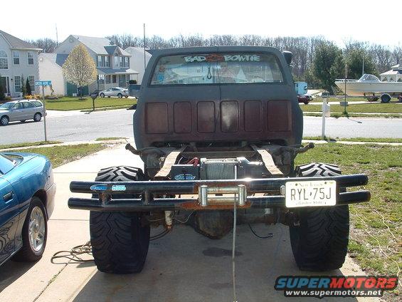

I used white paint to spray a line on how much of the plate I need to remove.... to be flush with the frame....

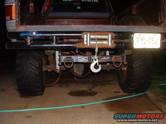

rear shot of truck.. I already see where im going to relocate the winch.... right above the rear axle....

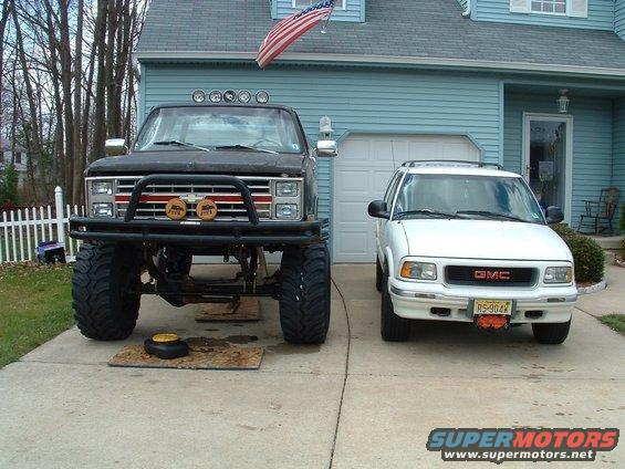

Hey Root,
Are you fixed at the maximum height by NJ's lift laws? I remember your rig being so much bigger! What are the specs on her? For the longest time you've been running those ground hawgs. You must love 'em!
I am watching your rear winch install with interest. I want to put one back there too! There really are no commerial bumpers I like that handle a rear winch.
Keep up the good work. Get back to the Pine Barrens. Your truck is too clean!
Manny

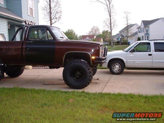

yeah truck was higher..
12" susp lift and 3" bl getting rocks and 53' michs.. but nj changed their laws thus had to come down.. truck sat in the yard since 1997 till 2004.. december 2004 truck got inspected and on the road..
specs are
6" superlift softrides up front with ord zero rates
10" rear full leafs, took factory block out
4.56's factory
added d60 front with 4.56's
added detroitz to all corners
mild motor
350 out of a 1991 caprice police car
added vortec heads
professional brand weiand power+ vortec dual plane intake
comp cams xtreme roller cam (.458" lift)-did that to have torque from idle
I have msd 6al and timing control to add....sitting in the garage
rear mount was super easy...
35" long 3/8" c channel 12" wide.....
total price was $40
other places wanted $80 for a 1/4" mount!!!!!

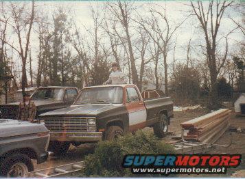

when I first put her together... 8 junkyard trucks... in 1989
in 1994 I added a 2wd diesel cab and bed

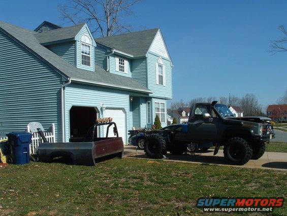

truck when it got lifted waiting rocks, and 53's
then laws changed in 1997
2003 brought truck down some by taking body lift off
the fun started and I dropped it and finished it up for the road....
then it has been a project ever since....

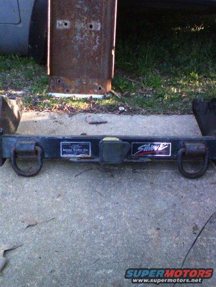

I also scored a receiver today....
we went to a place that the guy was selling a mess of construction tools... so I saw it.. asked him how much.. he said $30... my wife had $17 on her.. and he didnt want a check (I dont blame him)...
so I told him I would be right back.. off to wawa to tap mac for cash...
10 minutes later im back and he said he was suprised I was back and 3 people were standing around it.. I walked up and gave him the cash.. he said. it was sold and into the back of my truck it went...
this hitch has D rings on it!!!!! :shock

I think it needs to be redone.. sits too low...
gotta go up about 2-3" at least.....
what do you think?

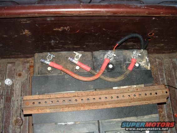

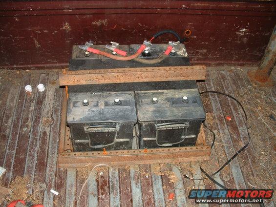

also got my dual batteries back in the bed of the truck....
I ran 10 gauge from my isolator to 1 of them....
all in wire loom and the clips to the frame...
3/0 cable connects each of them together...
I soldered the ends on and shrink tubed it all...
I like doing things right.. looks so much better..
shrink tube is sweet....
closer up...
you can see that I still need to hook my winch to the left side of each connector....
