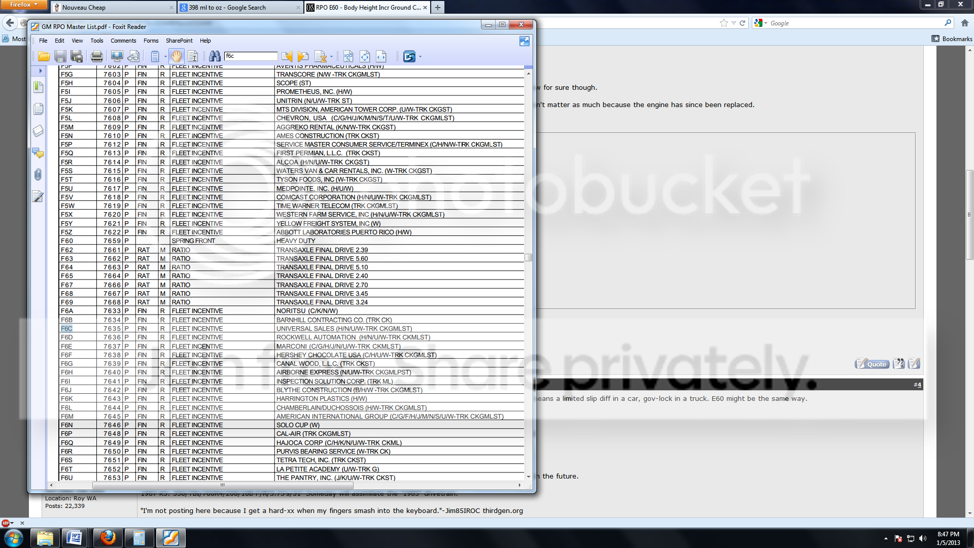

I just clicked on your RPO sticker and that is NOT E60 it IS E6C. A quick search and I find multiple people saying it means E6C = COUNTRY-GAMBIA
You may be right...it could be E6C.
But, what in the world does "East Africa" have to do with this truck? :dunno::rolleyes:
it could be F6C which is "fleet incentive ,universal sales".
Nope, if you pay attention to how the RPO decal is laid out you'll realize that the RPO codes are in alphebetical order from left to right and top to bottom and the "F" section starts 2 over to the right of E6C. :deal:
ahh true, completely forgot about that. well thats weird then.
