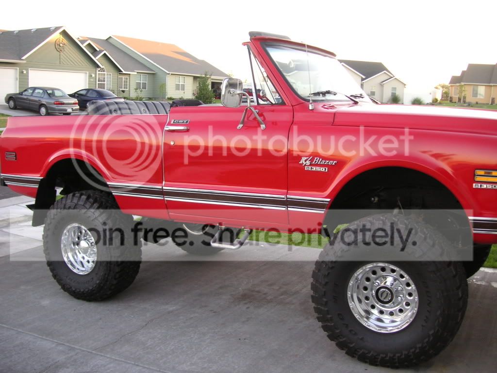

Rubbed one out in front of the nieghbors

:eek1: hahaha did a nice job too, used a power buffer and rubbing compound, took out alot of blemishes and waterspots

Nice truck, but isn't the CST emblem in the wrong spot? While I'm on the emblem subject, does your truck really need two "8-350" emblems on the same fender? :crazy:
Rene
The CST and the 8-350 emblems are correct for the truck. I 'think' the CST one belongs on the fender below the "K5 Blazer" one, abd the 8-350 is sposed to be near the marker light. I do know there were never two 8-350 emblems on the same fender from the factory, and I've never seen the CST emblem on the door like that.

lol, the emblem thing i didnt notice until after reassembly after paint and body work, all the emblem placement was done by the previous owner. The 350 emblem under the k5 emblem should have a "4wheeldrive" emblem and the correct placement of the "cst" emblem should be at the top of the door in the middle. I believe he put the cst emblems there because at some point he replaced the doors with jimmy doors and that is where gmc puts there emblems, so the holes were already there.
As soon as i got $50 to throw away at a couple 4wheeldrive emblems they will be there.

Seriously though can you go thru the procedure you use and name the products. Wifey bought me a power buffer and I still haven't used it. Truck could use a good buffing. Hasn't been done since paint job. It has been hand waxed a few times though.
Any paint supply place should be able to help you out, I threw away my empty bottle. I had a 3m rubbing compound that came in a bottle. It was fairly expensive if i remember right, around $40 i went over the paint with that, making sure not to burn through, be extremely careful on sharp corners it burns quick, use only enough to take out imperfections, there is a learning curve to this, it flings it everywhere if you have too much. I was using a wool wheel on mine.
After rubbing compound i followed up with mcguirers deep shine? it is labled step 2 on the bottle, followed by deep crystal wax Step 3
