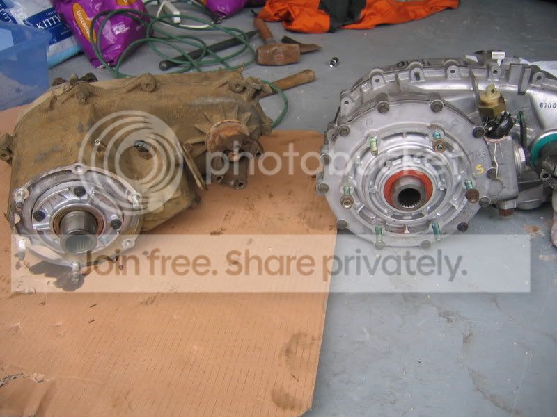

since the rubicons use a 241OR with 4:1 low range, is there any way to swap those gears into a chevy 241? i searched on pirate and to my surprise, i didnt see anything about people even asking bout it. is it possible? or are the cases completely different?
241 c on the left, and 241OR on the right. I was interested and this is the answer i received. Good luck.

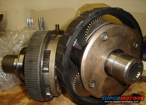

There is an Tera Low (IIRC) 231 4:1 ratio gear set that can be adapted to the 241. It runs something like $1200 though. :yikes: Donno if you can get a Rubi 241 for less than that though.

There is floor issues on jeeps according to the pirate thread its huge . Probably fit our trucks better , but looking at my floor , it would probably hit our floors too .
I know GM makes on the IFS rig a manual lever shifter for a drivers drop case , my 93 K2500 has the shifter . You could turn the lever over or use the GM lever on the case (just thought from looking at this pic ) .
The Tera low 4:1 kit will work on a 241c IF you machine the case to fit the larger planetary's.

I called Wayne at teraflex, and he told me that they machine a 1/4 inch off of the input shaft and machine the inside of the case to fit the gears. I didnt ask about a driver drop.
