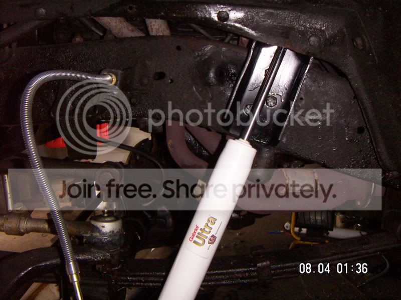

Rather than welding to the frame, I went with a bolt-on. There's a Ford Superduty piece you can buy at the dealer that's heavy cast and allows for longer-than-stock shocks.

I know of them but, you can't run any thing but stock replacement type shocks. The ruff stuff ones seemed like a good alternative to shock hoops.

Depends how you mount those Ford towers. I was running 15" travel shocks with my f-250 towers. FYI

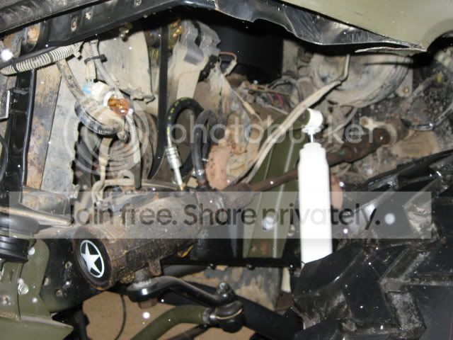

This was my old setup:
We pie-cut the top of the tower, leaned it over, welded, then notched it for the steering shaft

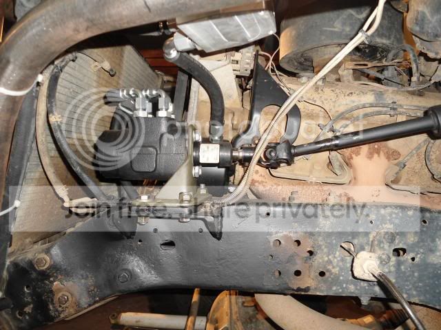

This is what my steering looks like currently:

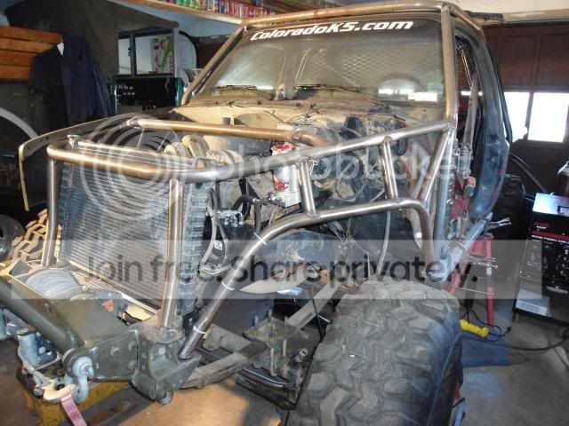

I'm going full hydro and we mounted the orbital on top of the frame so that we got more clearance to lean the shocks in a little more. The shock hoop will either be welded to the frame in a traditional style or will be mounted to my front cage work somehow:

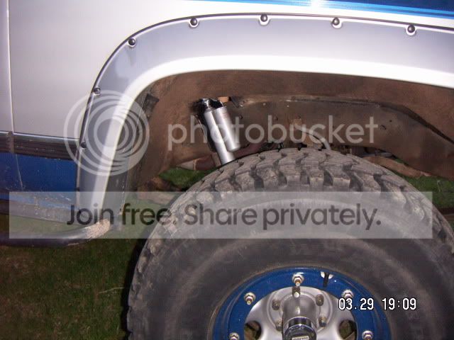

I cut a few inches off mine to run 12" travel shocks with about 5" lift.
