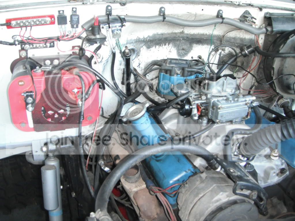

does any one have a picture of the batter tray actually intsalled? with or without a battery?
and if you have it up on the fire wall how is it mounted? i've seen the pics of them on the groudn but nothing showing how to mount or how to plan on it.
thanks for the help guys.
I run one from Ballistic, it's pretty similar. I can get some better pictures if you need.
It has flat bar running on the inside of the firewall to help spread out the load. I haven't had any problems so far.
There's room under the dash. I started the bolts by hand then had my dad hold a wrench on them while I hit the nuts with an impact.
