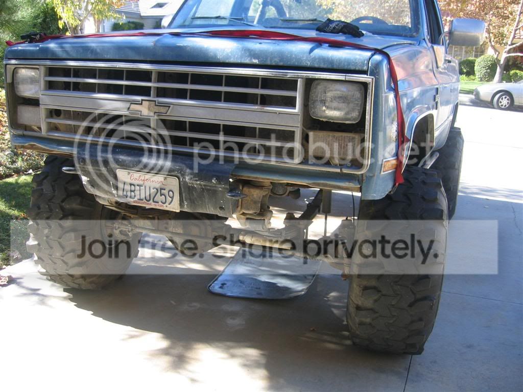

on a half ton i would keep the bumpers to help keep the frame as rigid as possible, to save weight(approach angle) i sawed off the bumper on either side on the frame

not much, maybe 30-40 pounds, this is what it looks like

I'm seriously thinking of cloneing your exact setup :bow: .. do you still have the bumper scraps laying around? I know its asking alot, but it would be AWSOME if you could weight the ends you cut off so that I would have an idea how much weight I will shed before I go to the trouble of breaking out the :hack:
