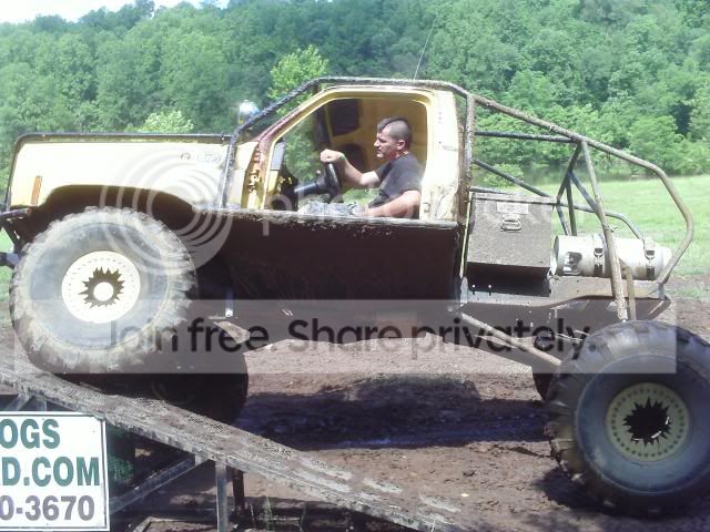

This is what I did.I just ran that diagonal and attached 1/4" plastic to the tube and all the way to the floor.
I know I know ,your gonna say "I dont have a cage".If you wheel you should have one.Chevy cabs aint as stout as you would like to think :D
