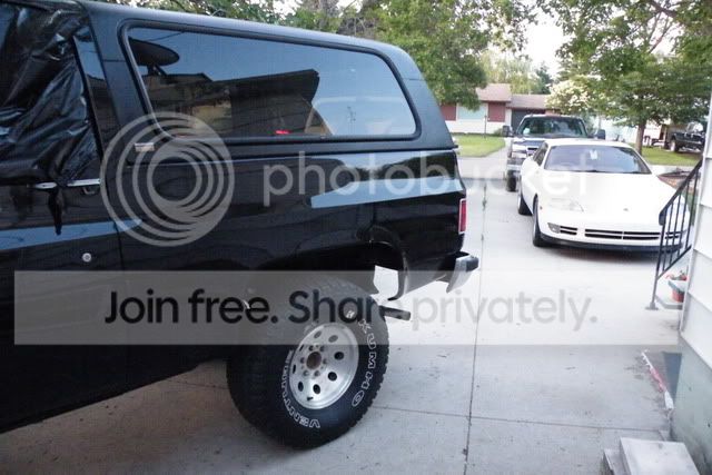

:mad: !!!!I was going to upload a picture showing some of the rust starting under the front wheelwell but I can't! I guess we're still having network issues :confused: Can't even upload new pics to photobucket
so here is an old pic just for the hell of it
well that works...
