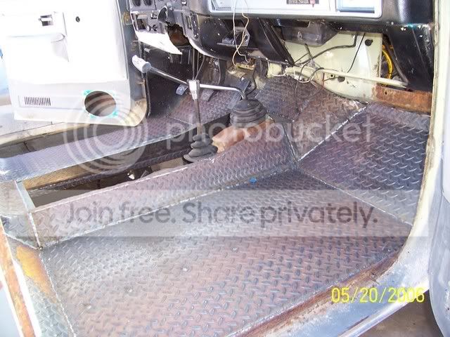

floor?
What about the floor? Should I just patch some panels in and call it good? Right now I don't have anything solid to mount the rollcage on top of.
Depends on how bad it is. If it's extensive you might want to do the whole floor
Get to cutting
Cut em out and replace with a heavier gage sheet metal. Replacement panels cost a good bit (200-400), but a 4x8 sheet of 14 gage was about 75 bucks

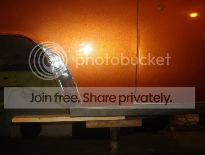

Cut out the rockers and do sliders. That's what most people do
I'd like to see some pictures of what people have done with their rusty rockers and putting in sliders. I know ORD's green truck has something like that on it. But can any one post some links?
There used to be a tech article from many moons ago about doing rock slider rockers with box steel. I forget who wrote it but it was on the main page and was one of the first times I had ever seen someone do something like that.
It's something I plan on doing next but haven't done it so no pics from me.

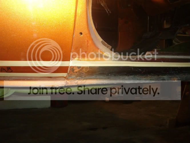

I'm assuming that it looks something like what Ryoken has done...
floors
Ryoken has exactly the perfect build thread for this. I thought maybe his was an old style, but its the same style as mine. My tube is just a little more gone then his, my quarters are almost rusted to shreads.
hopefully I'll be back on that pretty soon.. well, as soon as my seats come in... :wink1:
I found the key to fitting em up to be working off that sill cut at the bottom of the door.. just work all your cuts off that, forward, back and in...
I used a combo of a 7" cut-off wheel on a full size grinder, plasma and sawzall..
I've added to my design since deciding to do the cage now.. Not only will they be hard mounted to the new cab supports, but I'm also now going to attach them to the cage to frame tie-ins hopefully...
