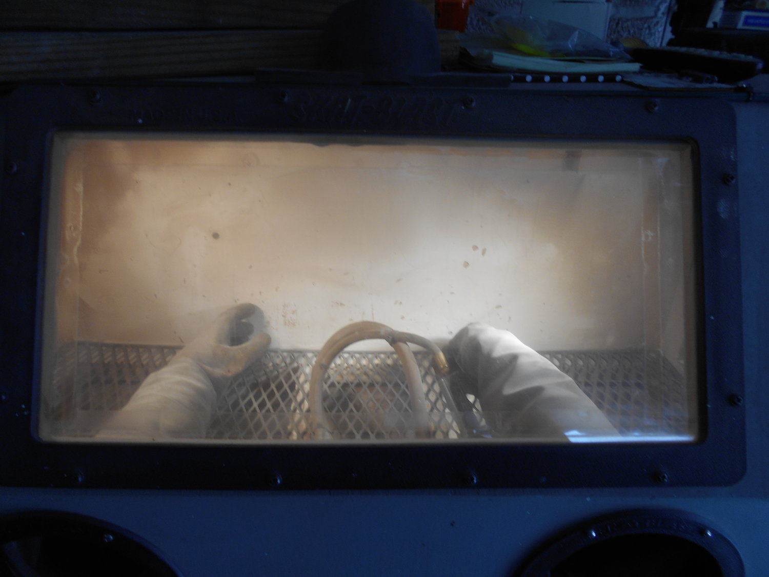

new scatblast, tip, and another light have the cab working mucho bueno....
full

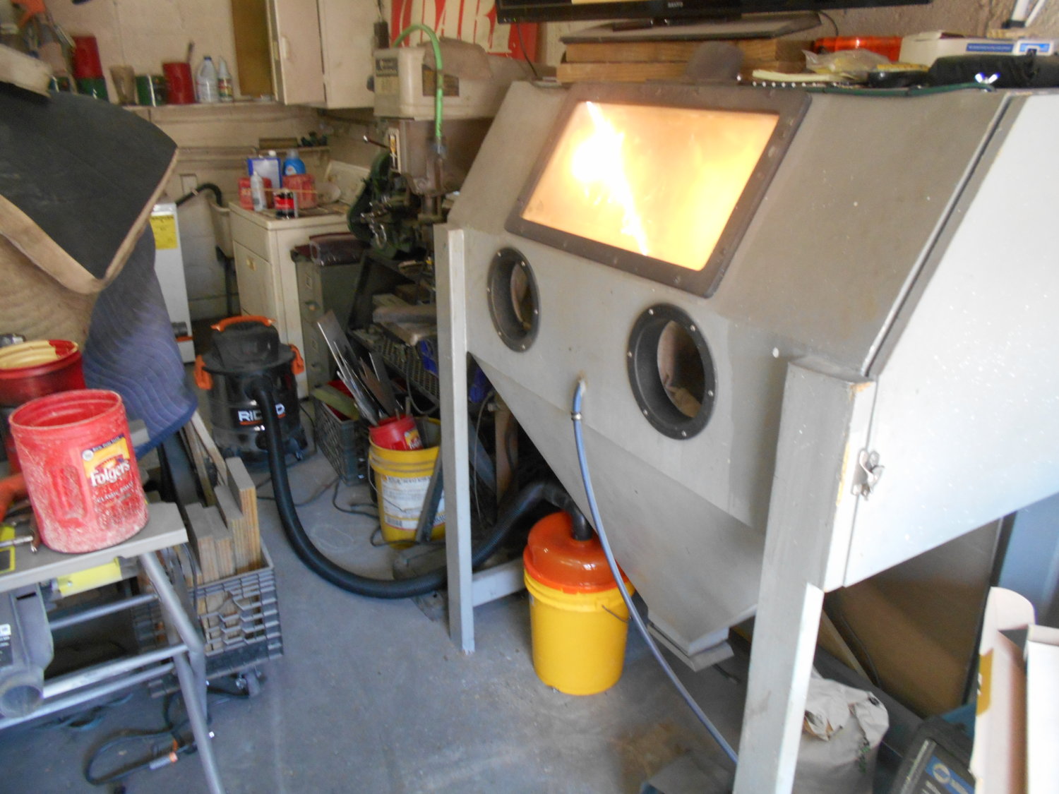

and here's how the collector is set up under the cab, vac further down.... seems to work awesome......... vac is clean and everything pretty much seems to be in the bucket from the limited use so far....
full
