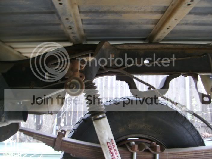

Let me go grab a quick pic of mine so you can see.
Added- Basically I just D/C'ed the bottom line and bent it down so I can run the line straight into the rear brakes. I left the rest alone.
