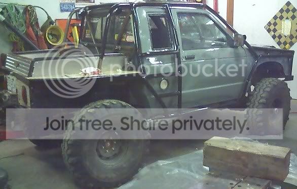

There it is The build will start in the next few weeks. The frames gonna need some work.
not really. I started doing lots of dirt bike riding but I pretty much got all the parts ready to go. I'm running trail gear yota leaves. about all that's really done is the frame is patched up. I've kinda lost my wheelin interest for now. I'll get at it though. It's mostly just put it together. Parts are all here.
frame is very thin in the front. have to put plates on the frame to weld to, the welds will tare off the frame rail. I did a solid front axle on mine and the front panhard rod bracket tore off the frame.
Yes, the frame at the front suspension area is very thin and week where it is bent and welded to. I had a hole pop open and hair line spider web fractures.
