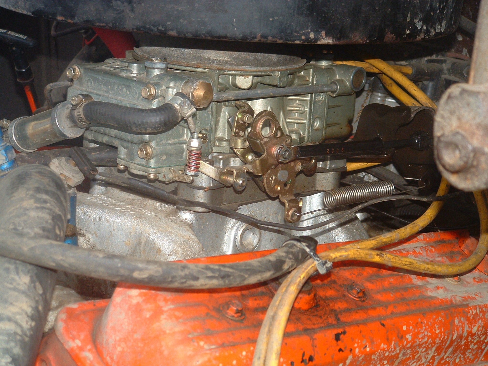

my delema is they dont actually make one for a chevy... so i had to make my own inner.... wish they did but still at the price.. not alot are willing to pay it as you can drop $50 on an all pvc snorkel.... :popcorn:
Did you use an off the shelf scoop though?
define scoop...
safari snorkel to fender.. inside pieces consist of pvc and rubber connectors...
to stock air cleaner that i cut down.
Since i have a holley on the truck and it came stock with a qjet... i found an adapter from a van... it was a holley riser piece for the intake...
love that thing...
you can vaguely see it here..
larger picture

define scoop...
love that thing...

Ah no I meant the part on the outside of the truck where the air enters the snorkel.
