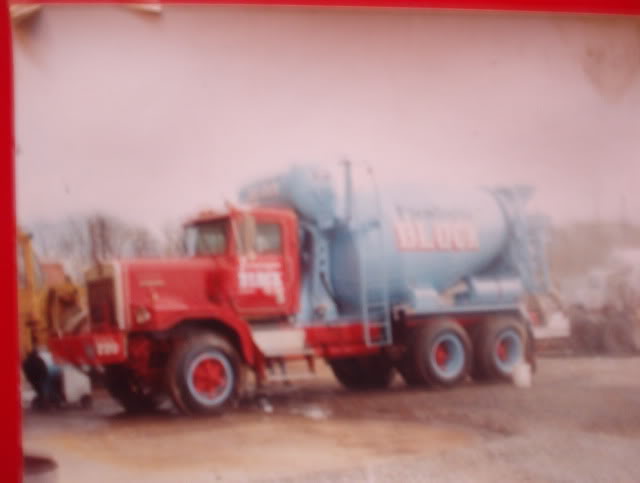

I'm a sandblasting snob... :haha: I started my career restoring cement mixers at Hunterdon Concrete running a 900lb Titan blaster, run by a 25' long IR tag along comp.. thing would cut cement block in 1/2... :pimp1:
good 8 to 10 hr day would turn this whole thing raw steel.....
full
