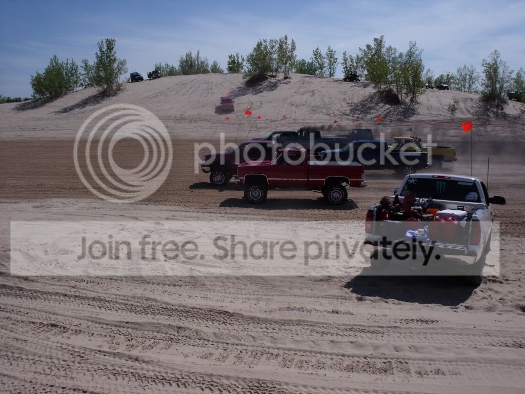

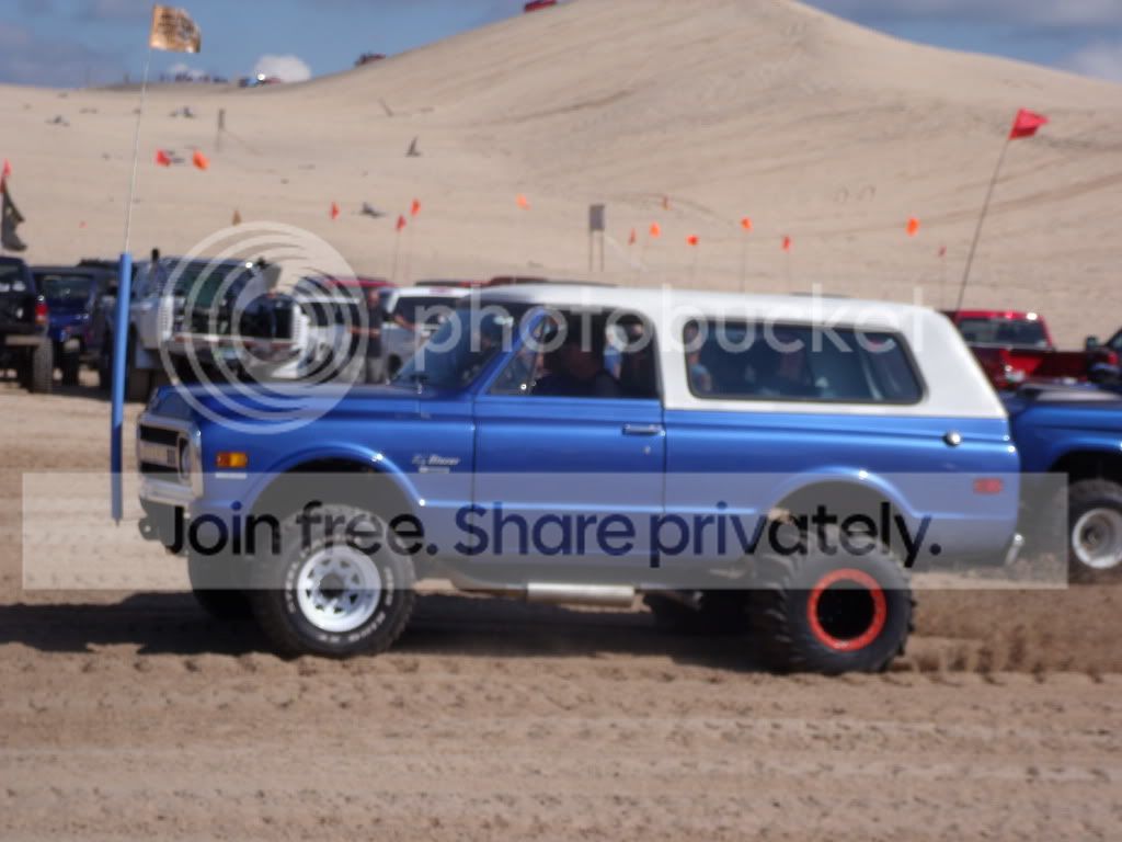

I'd be more inclined for something like this:
Well the only thing with that is you got one purpose for the rig. Where if you build a rig with some power and nice suspension you can drive it around and drag it. Idk what his plans are. Just got back from the dunes hehe :D
