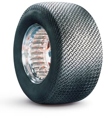

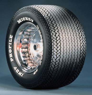

A few years back, I recall reading that Mickey Thompson Sportsman drag tires, these:
or these:
work GREAT in the sand....wide, don't dig, and float factor is very high. I've never seen these on the sand ('cause I don't play in sand), but logically, it makes perfect sense.
thats the nice thing about the fun countrys but the got more bite, are radial and better on the street
but installing such tires would really take alot out of the engine the car will have more traction which will require more power from the engine..
