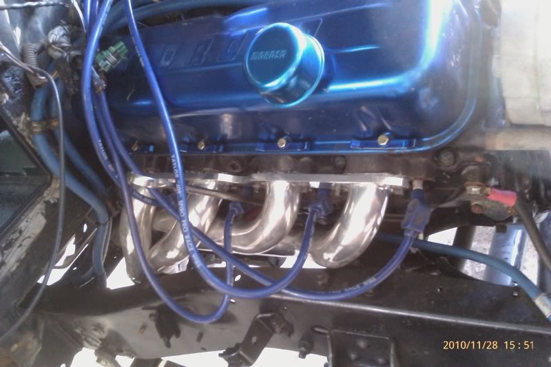

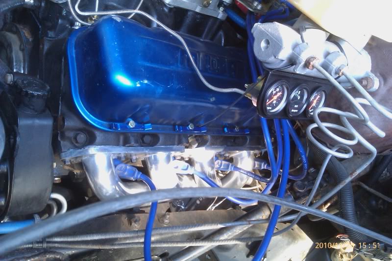

Here are a couple of bad pics of mine that sort of show the space between the frame and headers. I'll try to get some better pics and lunch and update this post.

something to consider, how far could a motor sag from worn out mounts? seems like more than just being a hair too tight to squeeze through but that could be part of it.

I'm thinking yours is showing more space between the headers / frame than mine has. I'll snag a couple pics in a little bit to show difference though.
