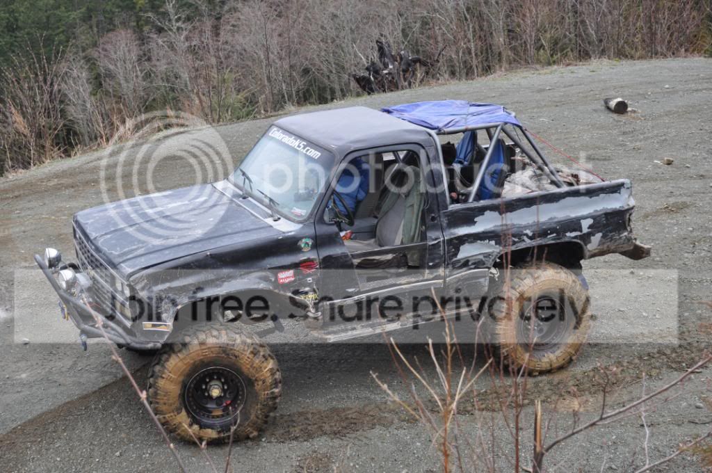

I guess to answer a few questions pointed at me. The reason I want to go with a roll on, is for simple touch ups. I plan on wheeling this truck, without the Brian dents, but paint missing and all that good stuff. Even with damage, I'd like to be able to break out the roller, and touch it up. Simple. Cheap, solid color, look better than primer, and easily touchupable. :) Nice cage btw Brian. :D
