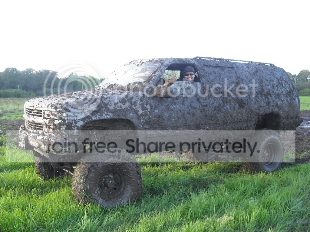

oh a pic of it to keep you guys happy.
haha jim looks excited, but i was talking with him and maybe there is a SYE kit basically like we can get for our 208s except for the front in this case. is there anything like that made?
