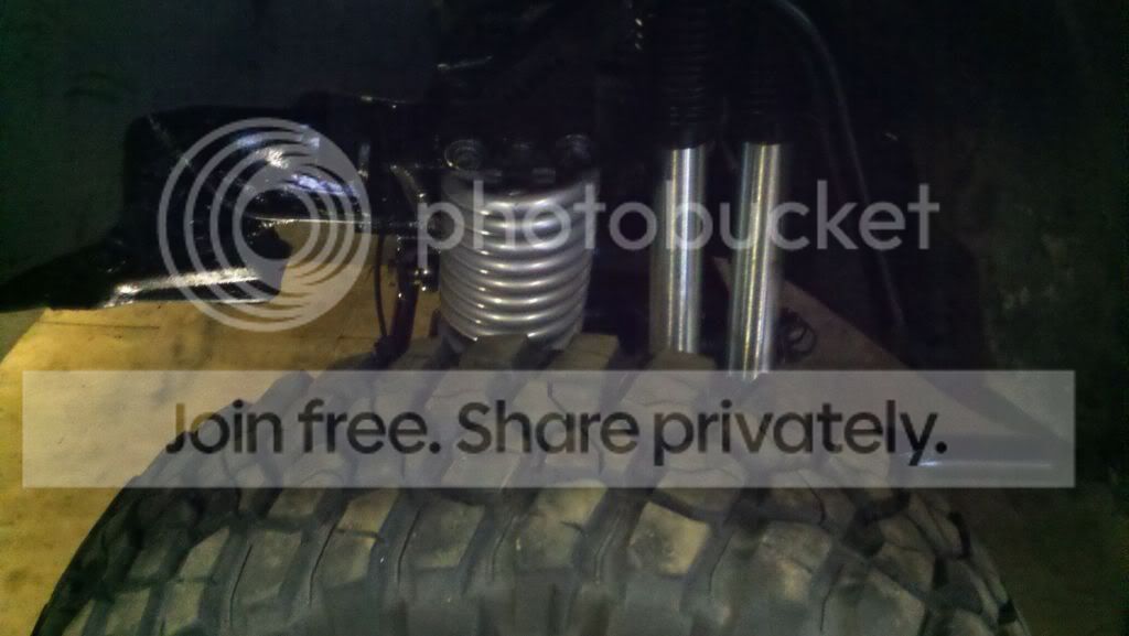

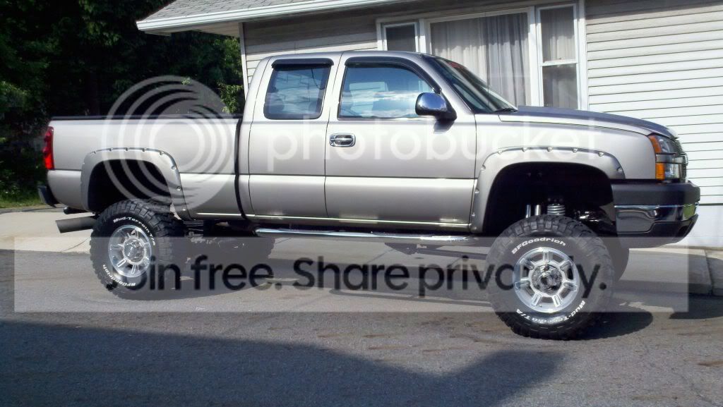

Radius arms, coil spring, dual shocks......but a ford 60 with chevy outers and a np241 case.............pretty nice i must add...lol. Too tall for 35s but with shorter coils would fix that. I have new softer one inch lower springs to put in, there actually 6 inch lift bronco coils, the new ones are 4.5 lift coils. I get right at 8 inches of lift this way. Up travel is limited straight on but when flexed with the radius arms it moves alot more than you would think.
Heres a pic..or two:whistle:.....the coils are progressive rate so there meant to be togeather at the top, the wire shown is the abs tone ring kit on the 60 hubs.
I did a build of it here, Still not done tho. Drive able and it drives very well, no bumpsteer or wandering. But still no front shaft and it still has blocks in the rear. Was a little expensive but that depends on what way you wana go with it. Will be done before winter..
