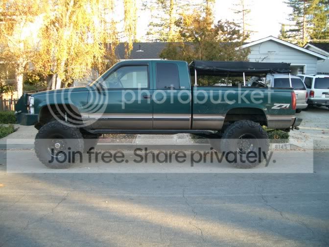

you take however many inches of lift the hangers you have give + the lift springs+ if you have a zero rate or not and thats how much lift you get, you can fit 38s on 8" or so if you cut but youll need a good bit more if you dont
here is a members truck with 8" and 38s
