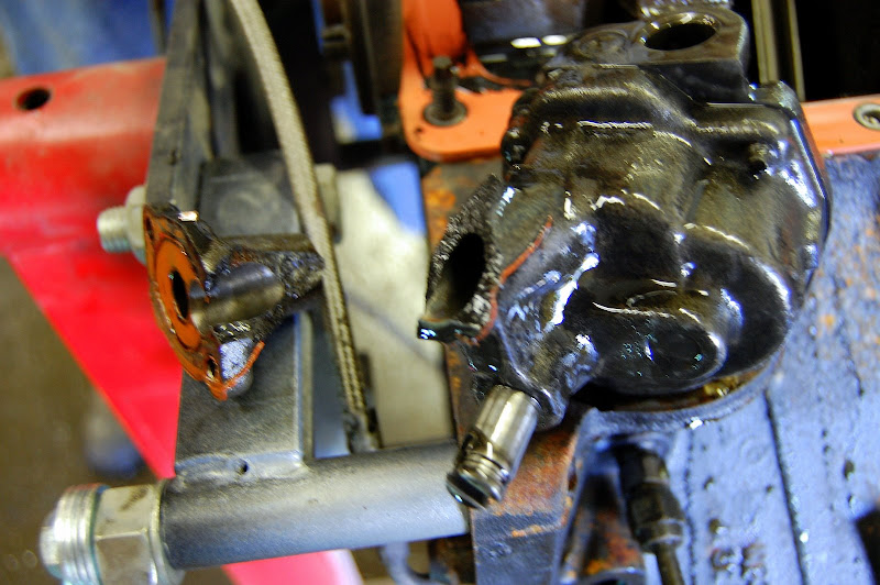

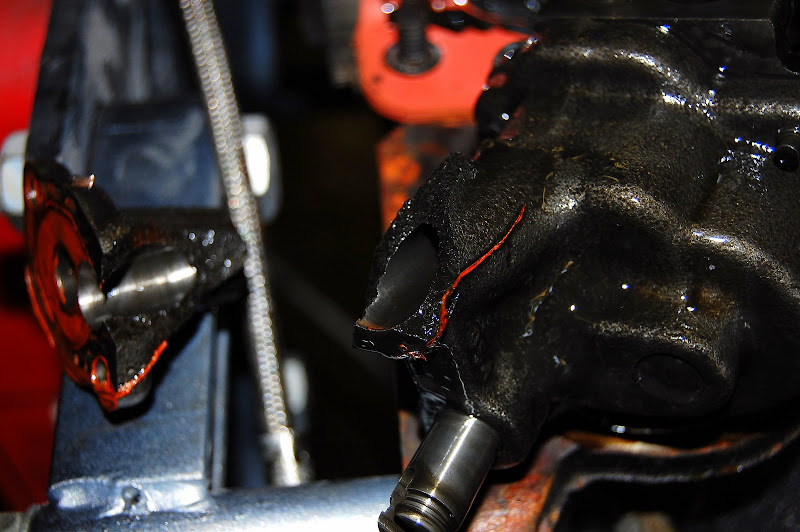

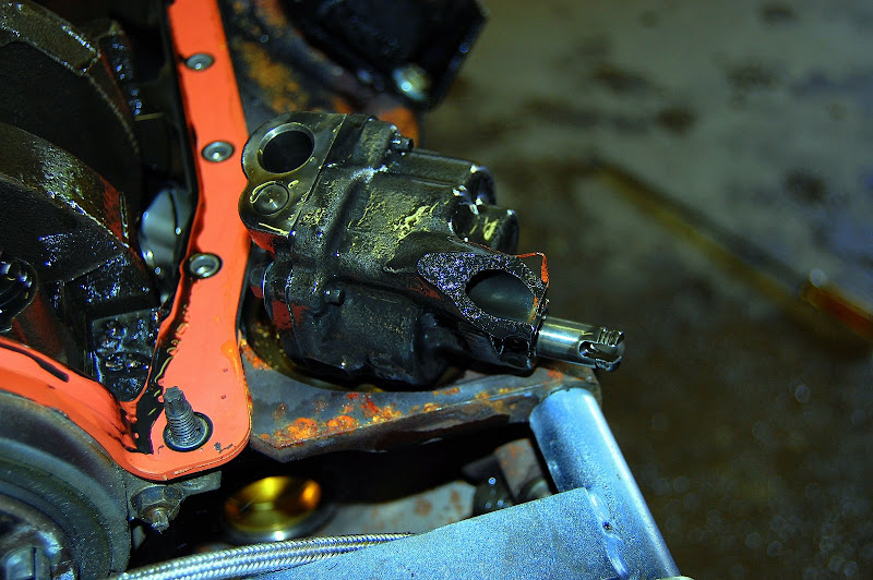

Well way back in June my GMC Typhoon suddenly dropped oil pressure and I had my Typhoon towed home. Pulled engine and found the Melling M55-A pump was broke in 1/2 when we removed the engine and pulled the oilpan. Later on I found out that Melling made a design change to have a thinner/weaker casting to save $$$, and there was no notifications to the consumers about the change.
See this thread for more info:
http://www.syty.net/forums/showthrea...hlight=melling
After contacting Melling, they sent me several forms and requirements needed to send the pump back along with receipts of machine work/part costs to repair my engine ($2500+).
Today I received a response back where they acknowledged the broken casting but warranty was denied due to it being used in a 'performance application'. I assumed this would happen, but I had nothing to lose..
I can scan the response I received when I get home.. but here is a jist of what was mentioned:
Quote:
Condition of Received Part(s): The bolts are tight, the gears turn within specifications. The casting is broken off at the mount pad.
Analysis Comments: We did see the broken casting, this pump was used in a performance application, we send a warning sheet with this pump stating; use M Select pumps for anything that is not an original stock application.
Analysis Results: The Melling Warranty does not apply to pumps used in a performance application. We did not find a manufactures defect in the pump or in the workmanship.
*I bought the pump back in the spring/summer of '06, no sheet stating use of M-Select was included! I have checked with others including sellers of the pump and they mentioned that this Warning Sheet was not attached with the pumps until recently. Did not finish assembling engine until fall '06 and put directly into storage. Next spring got Typhoon out and put apprx 1000 miles on new engine w/o a problem til the failure occurred.
Just a warning to you guys, that Melling was very shady about this. Talking with them on the phone I felt like I was being spoke to like this oil pump failure was my fault. Melling knew I posted the original thread and questioned me about it on the phone, from which I took down the pictures of the broken pump. Ed Hess (another SyTy owner) has had the same problem, along others while searching around the net.
Here are pictures of the oil pump where it broke in half, you can easily see the casting broke:
They still have my broken pump, I have till Jan 7th to request it back, not sure if it worth the shipping or not.. This is a known issue by Melling and they know darn well that this pump has been used for years by engine builders and they decided to make the changes w/o letting anyone know.
