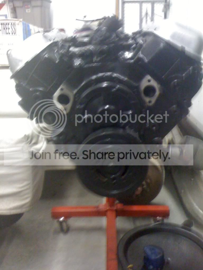

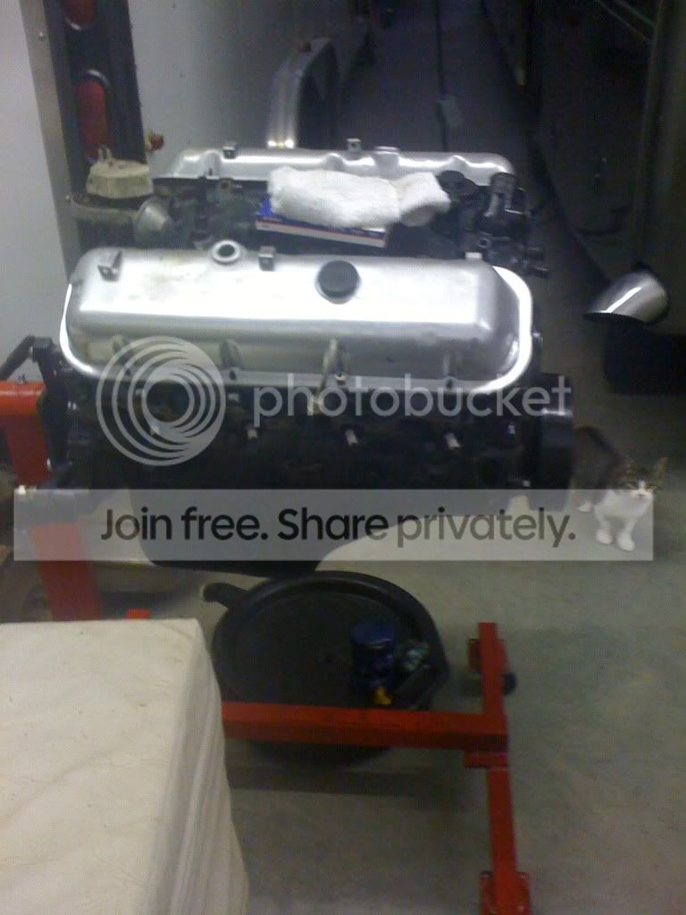

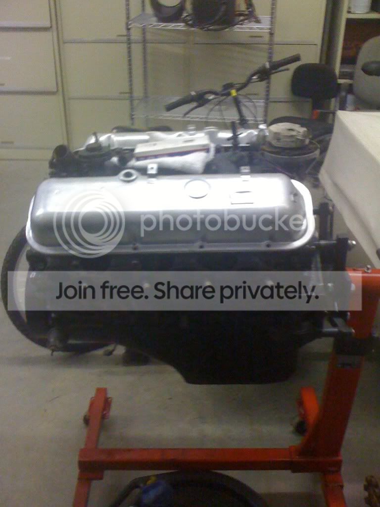

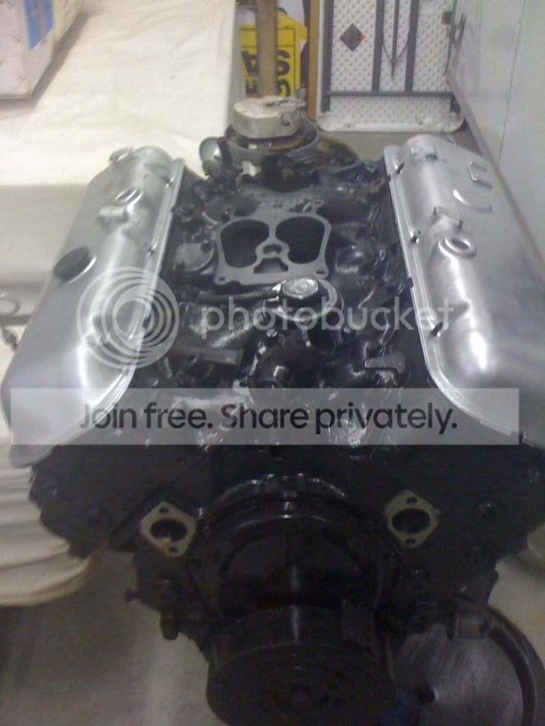

Have this 454 and I don't know jack about engines.. pulling out my 350 and dropping this bad boy in...what all do I need this is all I have.
I got a carb and headers but what else is need.. I know accessory brackets and a crankshaft pulley. What else?

Probably motor mounts,
make sure the radiator is up to the extra heat,
extra fuel supply, should have a 3/8 line for a big block,
Flywheel if balancing is different between the 2 engines.
How can I tell what type of vehicle this came from. The numbers on the intake say 6 13 85 which I'm assuming is the date. And it has HI PERF stamped on it in multiple places. But will one of the numbers on it tell me what kind of vehicle it came from?
Make certain that it is a 454 because the flexplate/flywheel is different than every other BBC. The date code on the intake does indicate that it was built June-13-1985 so from that alone should be a 454 IF the intake is the original one from that engine. There is a casting number on the driver side bell housing area of the block which will get us in the ball park of what you're dealing with but there is a stamped in letter/number combo on a machined pad of the block just in front of the passenger side cylinder head which will tell EXACTLY what it came from.

That is cast into all BBC's, really means nothing.
