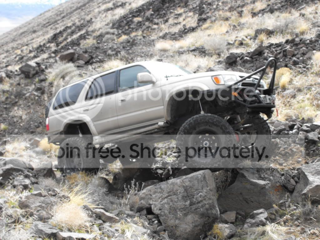

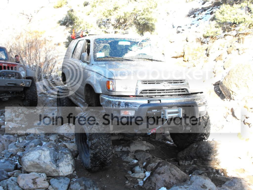

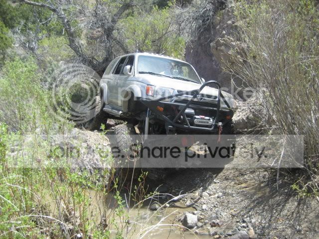

If you like I got some pics of my old Toyotas in my garage pics.

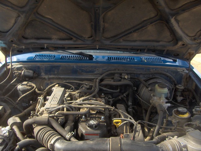

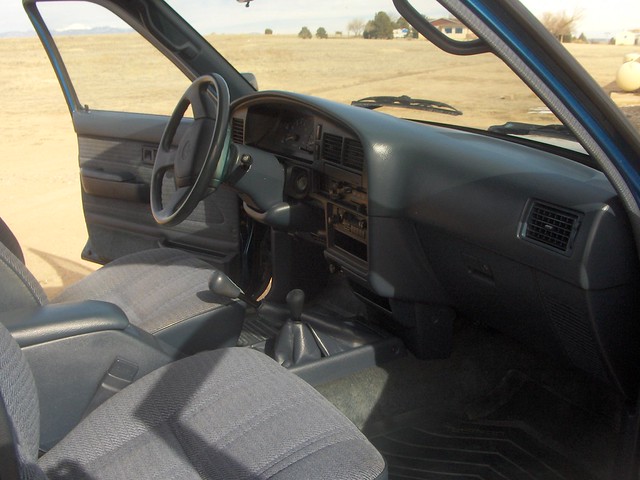

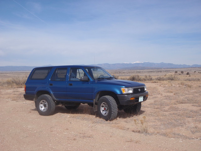

This is a 1992 22RE rig we picked up this past February from the original owner with only 122,000 miles on it. All I have done to it is tune it up, paint the wheels and added new tires. This little thing is like a time machine back to the early 90’s all over again. It needs nothing….just more power! This is actually my wife’s off-roadster.
Before powerwashing the engine and tuning it up
The interior is flawless. Even the tape deck and A/C work :haha:
The wife love it plus it matches my K10 well. Like mini-me
