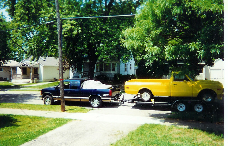

I drug my little ’68 1800 miles from Colorado to Detroit back in 1999 when the Z71 was a year old. It tore the arse out of it to pull this load across country. 5th gear made an odd gurgling sound after this trip until the day I traded it off. I had to add my own receiver hitch to this truck as GM did not offer towing packages with the NV3500……for good reason. They didn’t want people towing with it. The poor little 1/2 ton couldn't handle the weight of the BB in front of the GMC so I had to turn the GMC around backwards to even out the load. It was a fun truck to drive though, except in Detroit traffic.

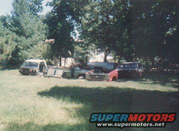

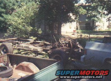

I took my body off my auto and put it on a 1978 Chevy tailoring special 8400gvrw...
My auto

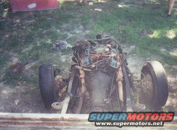

My new drivetrain
Mess in the yard (1988 fyi)
